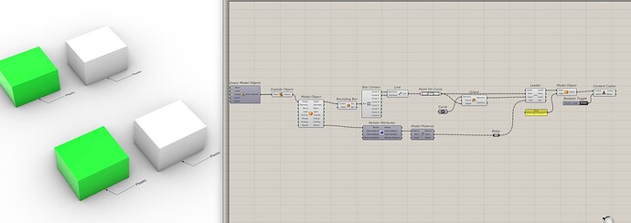

Hi Simon -
If you are proficient in Python, I see that Scott added a script in that other link a few hours ago.
For a quick Grasshopper example:
→ Add Material Leader to Block Instances.3dm (2.1 MB)
→ Add Material Leader to Block Instances.gh (9.7 KB)
Ah your grasshopper solution looks great. I was just hoping you might be able to explain how I might be able to add additional objects into the block, with different material codes, and create new leaders? This would cover what I need.
Thank you
I managed to get some more blocks created with tags. However, when I added the third block the material code overwrote one of the other tags and I’m not sure how to create a second leader if I add a new object.
If you are able to help it would be great. Thank you
Hi Mr Simon,
The idea here is that after changes are made you run the script, this will modify the previous iteration, removing and adding in new leaders as needed.
There is also a option to use a Named Content Cache, this would leave the previously named Cache Leaders alone if need be. There are also ways to ensure you are only getting the objects types you are looking to tag.
R8-Block-Leaders.gh (10.8 KB)
R8-Block-Leaders.3dm (389.6 KB)
