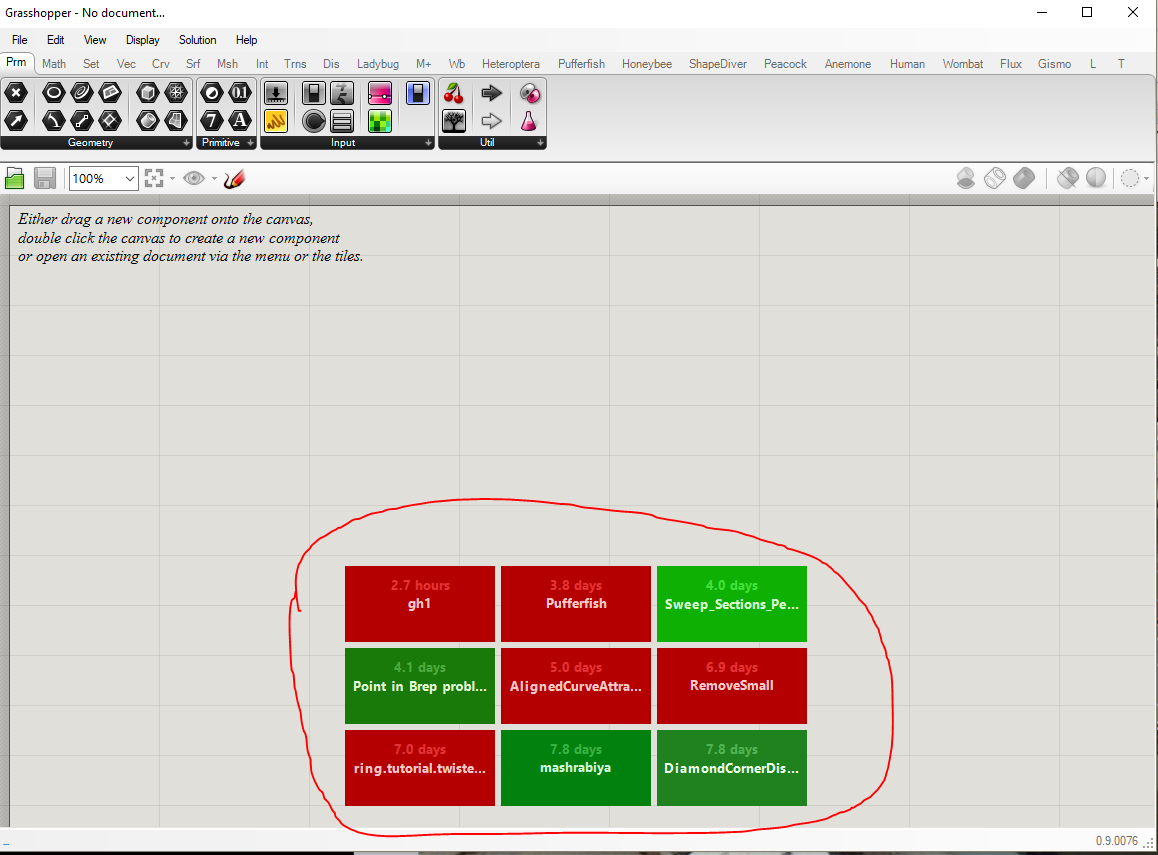

Hi, i am very new to Grasshopper and installed add-on Pufferfish before I even started to learn Grasshopper (I know I am being gready). And now whenever i tried to open rhino models in Grasshopper I always have the Pufferfish interface, is there any way to remove the Pufferfish from Grasshopper? I have tried delete it from special folder and re-install Grasshopper, but it’s not working. Thanks

Hi. I tried to rebuilt the model in new file, but when I open Grasshopper to edit curve i still have Pufferfish. is it possible to use Grasshopper to edit my rhino model without Pufferfish? Thanks
You are very confused. There is no pufferfish there, I repeat No Pufferfish. That is grasshoppers “recently opened files” menu. Just add any component to the canvas and it goes away. It says Pufferfish cuz those are the last files you opened. Once you start making and saving or opening new files that green menu will be those more recent files, has absolutely nothing at all to do with Pufferfish.
See these are my recently used files:
They are just a shortcut to recent files incase you want to quick open them again by selecting one. If you just add any component to the canvas that menu goes away. like this:
