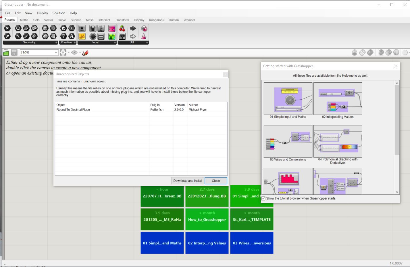

  1. when opening the grasshopper file itself it seems pufferfish is missing, error message:
    this file contains unknown objects
    round to decimal place / Pufferfish / 2.9.0.0. / Michael Pryor
  2. when chosing download and install i get a package restore error:
    trying to download and install missing plugi-ns
    404: No package found by the name of ‘Pufferfish’.
    Failed to install the missing plug-in.
    Not all plug-ins were found on the package server.
    The missing plug-in(s) may be available at https://www.food4rhino.com.
