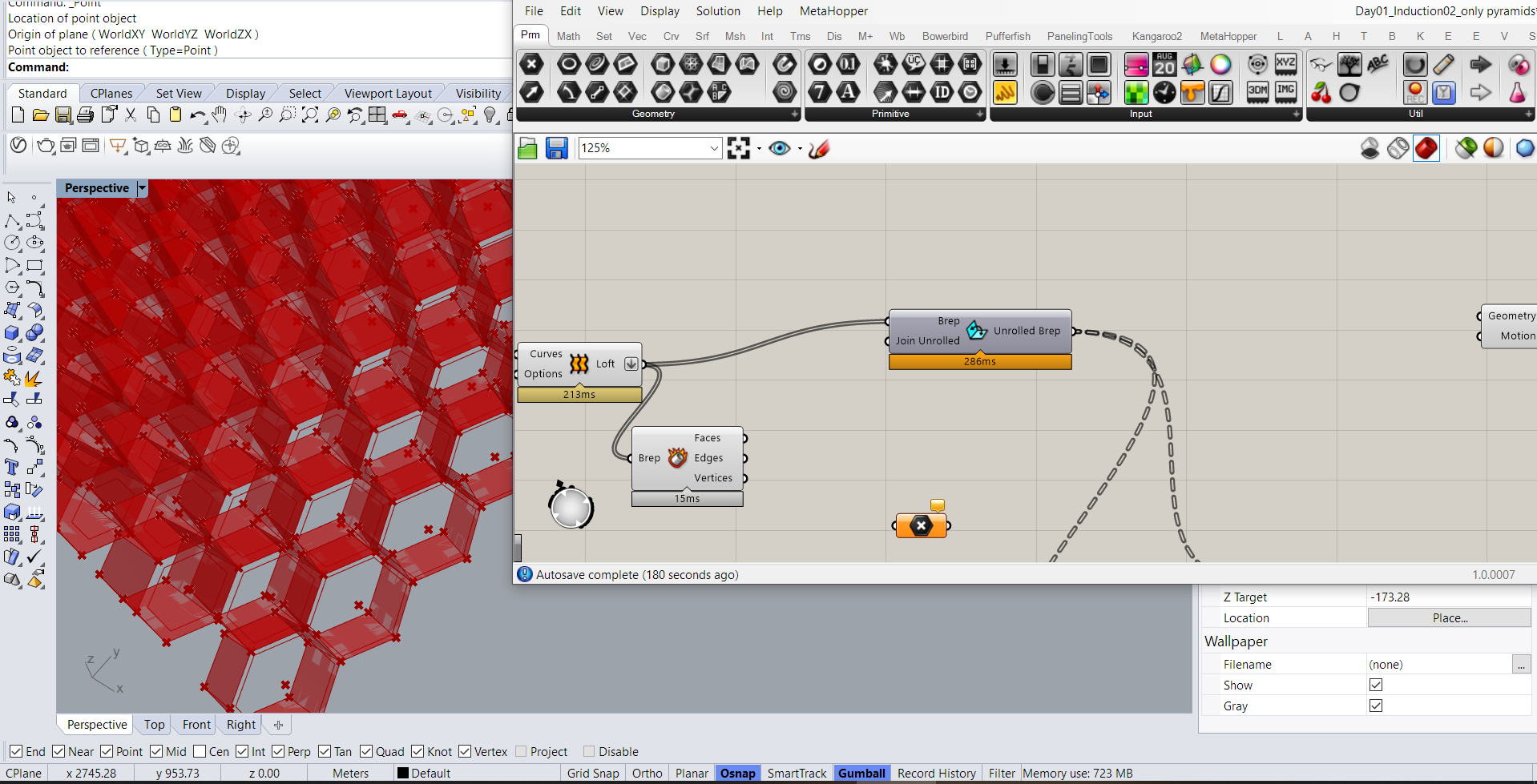

I have a series of hexagons that I lofted to create pyramidal extruded surfaces. I want to unfold them and create separate surface development for each of the pyramidal extrusion. The trouble I am facing is that the resultant surface development creates multiple polygons for each single pyramid and I am not able to figure out how to treat individual surface development as a single entity so that they can be arranged on a grid.
Please help
HEXAGONS UNFOLDING.gh (12.5 KB)
Another query is, that in order to save on material and prevent wastage, how can I arrange the result surface developments on one single sheet?
Set boolean toggle to “True” for lunchbox Unroll Brep would help.
HEXAGONS UNFOLDING_re.gh (12.7 KB)

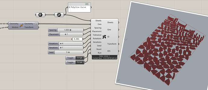

Moreover, in order to save on material and prevent wastage, how can I arrange the result surface developments on one single sheet?
HS_Kim for sure, mine was quick solution, not considering the geometry.
Have a try opennest plugin.

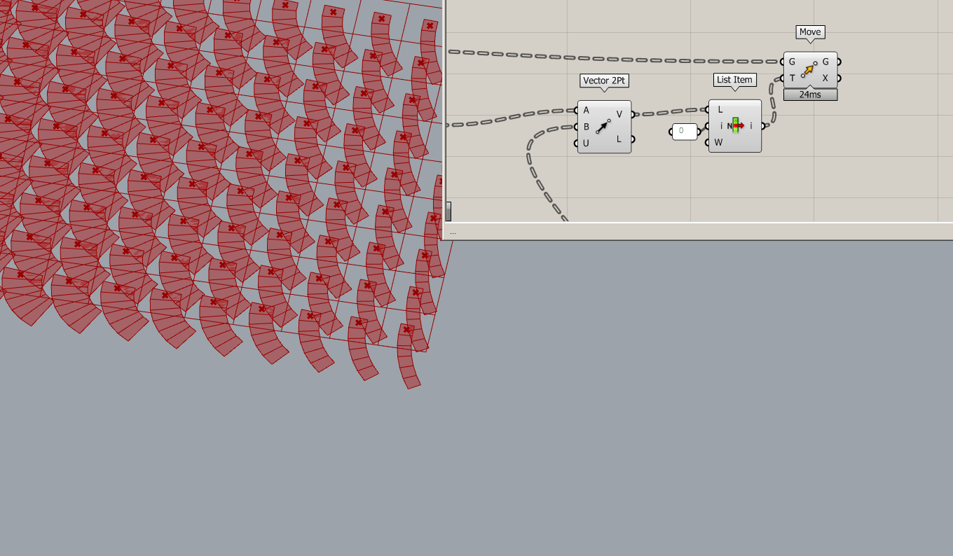

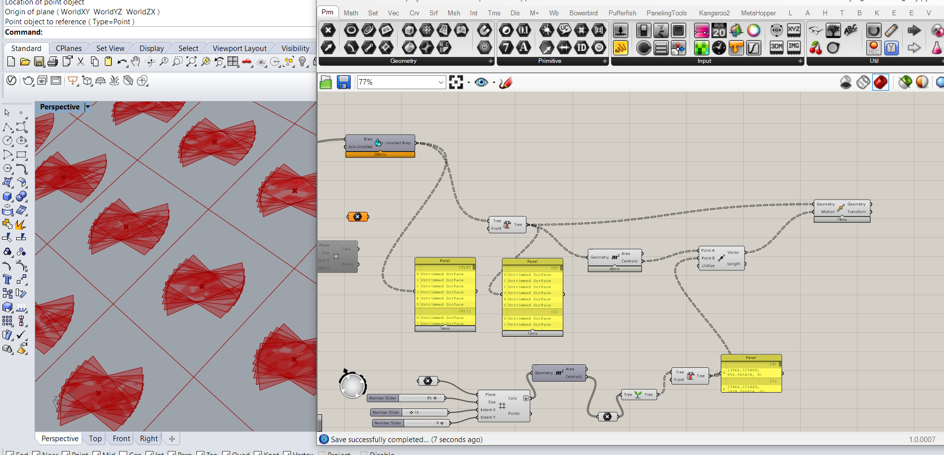

Okay , I tried. This plugin is resulting in lot of overlapped geometry. What to do?
HEXAGONS UNFOLDING.gh (14.1 KB)
HEXAGONS UNFOLDING _Nesting_re.gh (18.3 KB) Please download the example files and take a closer look through them.
Thanks!..I just increased the seed in my original file after comparing with yours, and also flattened the geometry which resulted in properly organized nesting. What is the function of seed exactly?

Seed are used to randomize the nesting. Most of the time nesting can’t explore all the possibilities, so it begins by one piece, then another … Seed enable to test differents orders

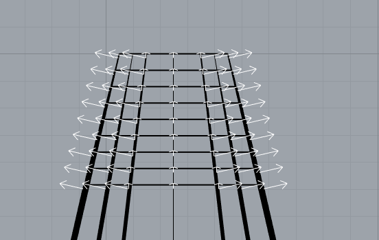

side of the cut, did you check the orientation of you loft and the orientation on the plane ? You need to decide which side will be on top
Also material have physical thickness so modeling with 0 thickness is not good for all purposes
Long … long list of parameters you have to take into account.
What is there to check in it? The loft is oriented from bottom hexagon towards the top hexagon. All the hexagons are oriented as a grid originally. Then the nest plugin orients them automatically, in a random manner based upon the spacing of individual unfolded geometry. What type of orientation needs to be checked?
Loft here are oriented in a “standard” way. Direction (use Dir command in Rhino) is like that
But all the surfaces from the Unroll component have not the same direction
So it could be OK or NOK depend on what you need. If not OK you will have to flip some of the shapes before the nesting.
