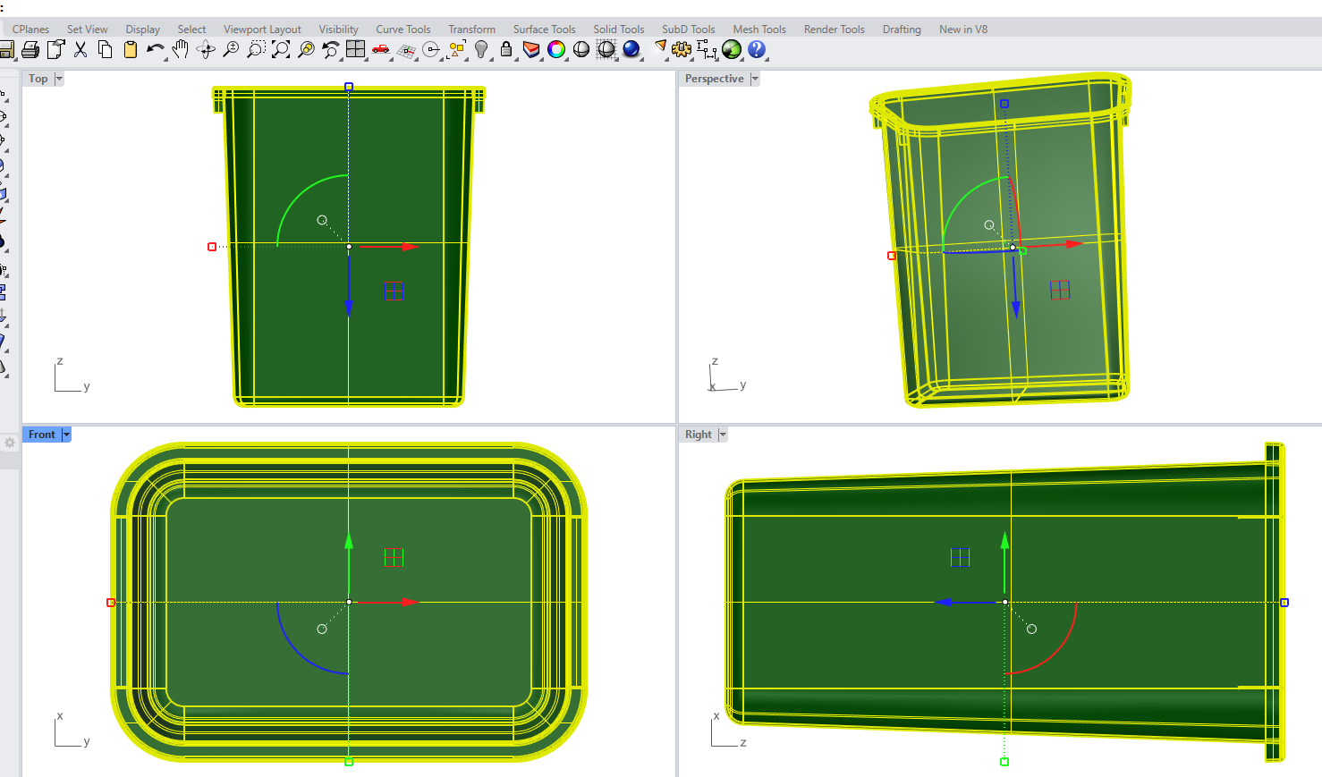

Here’s a pic. I also saved it and the file size is about what I expected, and the layers are matching the assembly items. So its importing something, somehow.

This is weird. After importing the assembly and it not showing up, I undid that command and my existing Rhino model parts had disappeared from all but one viewport and aren’t coming back.

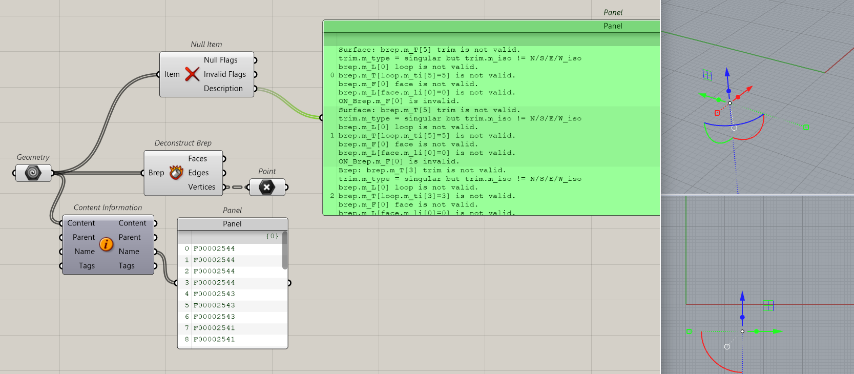

You’ve got a number of bad object, SelBadObject then Delete
32 surfaces, 9 polysurfaces added to selection.
You can use grasshopper like so to get additional info about said objects.

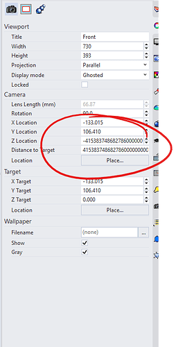

^ that is the file in the screenshot above, where there are no objects selected when running the selbadobject command. Missing in one viewport. Even if I delete all the objects in one of these files, new objects (new box, srf, etc) wont show up in the viewports that arent showing anything.
your camera is way out in space somehow…
set it to 0,0,0 then select and then zoom selected in your front view.
