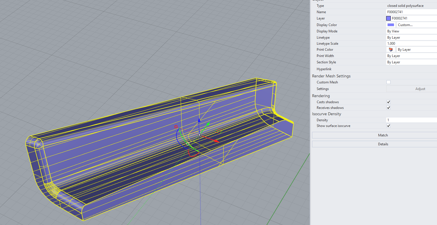

Hi Colin, I’ve narrowed it down to this object, it has an internal point that causing the camera issues.
Copy and Pasting into a new file without that object will clear the camera issues.
Can we get the original file that you imported for this part?
