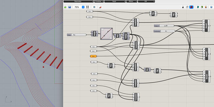

I’m generating tween curves between an outer outline and one or more guide curves in the middle. I can get nice transitions (blends/tweens), but I’m stuck on (1) joining the split segments in the correct order and (2) cloning a motif along those curves to get a pattern.
My Goal:
Creating pattern:
  • Inputs: outline curves (boundary) and guide curve(s) in the center.
  • Generate tween curves between outline and guide(s).
  • Where tweens split, maintain a clean, smooth connection.
  • Finally, divide the resulting paths and map a shape/motif onto the division points so it orients to the curve (to build a seamless pattern).
What I have working
  • Tweening between outline and guide curves (and visually it looks good).
  • Using Rhino’s Blend (and GH Tween) I can get the curvature I want.
Where I’m stuck:
  1. Ordering/Joining: When the tween curves split, I can’t reliably join/sequence the segments in the correct order to form continuous paths.
  2. Shape mapping: I want to divide a path, clone a shape onto those division points, and have each clone follow the local tangent/normal so the pattern reads smoothly along the curve network.
Questions
  1. Best practice to enforce consistent curve direction before ordering?
  2. Robust strategy to order split segments along a “spine” or index curve? (e.g., sorting by intersection parameters vs. endpoints proximity, or a graph approach?)
  3. A Recommended way to orient geometry along divided curves so it doesn’t flip and optionally scales by local spacing?
TweenCurvesBlend_autosave.gh (7.1 KB)
FIT_Curves_00.3dm (2.9 MB)

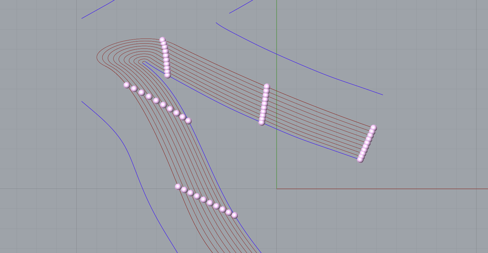

I do not know if I really understand what you are searching for, but maybe this helps:
The output of the two TweenCrv’s + their Connecting BlendCrv => Join Curves
(what only works if all three datasets have the same order!, like you have here)
Now you have 10 continuous paths
To place some objects on the path:
I used PerpFrames to create a couple of planes along the paths. And used Orient to place a sphere (as example object) on every plane.
TweenCurvesBlend_EW.gh (19.6 KB)
