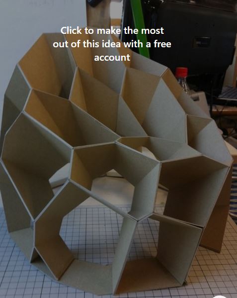

Trying to extrude the Voronoi lines
I am trying to extrude the Voronoi lines so that I get the side surfaces. But this requires that I have a normal vector for each cell. This trick didn’t work because Voronoi cells are not planar. I ended up using scaling the center points for the vector. But unfortunately this completely skews the side surfaces in some areas.

but i think two problems is seen in your model
first, the extruded cells thickness is not different. it is wished that an attraction point was existed to pull the thickness of cells differently
and second, the rows placed on the floor is not flat however i know its algorithm is complex
is there any solution ?

thank you @ajarindia
your first try all cells was in one direction that it wan not my solution
but the second solution is thing that i want but considering the real image in the first topic, the amount of extrusion for each edge is different ; how we can do this?
