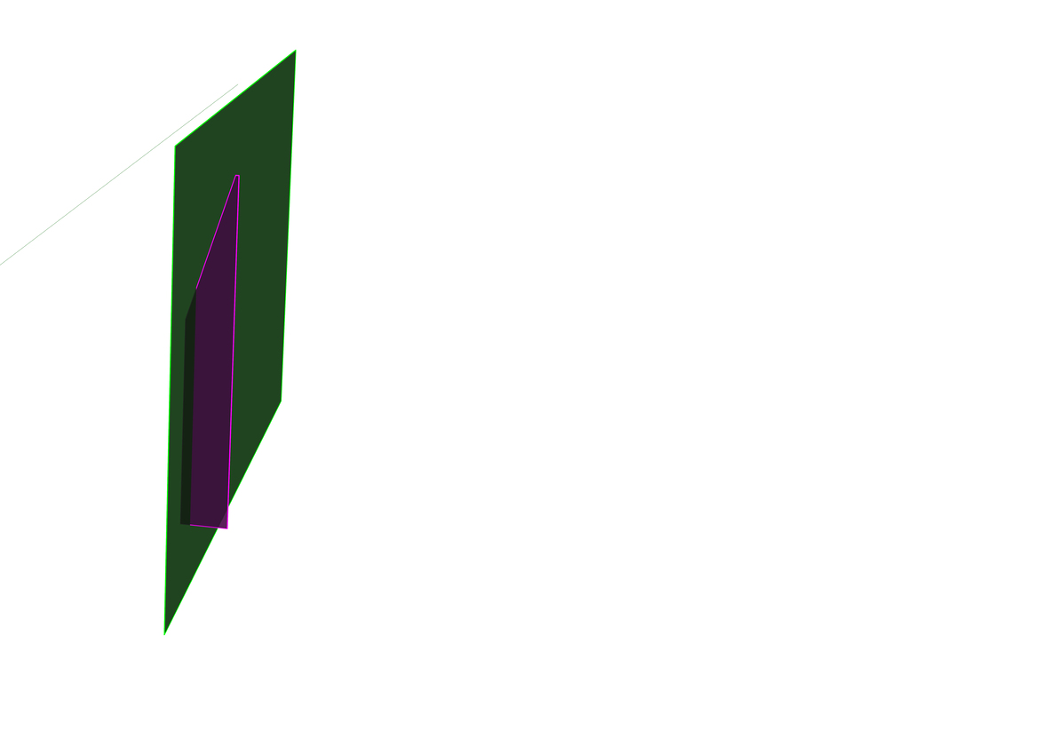

you need the rhino file I suppose instead of just a picture
I have encountered the issue some times, it does not happen always off course, but it refuses to trim the pink sf or to find the intersection between the two surfaces
this is the file which contains the two surfaces which Rhino fails to intersect
rhino fail intersect example.3dm (1.2 MB)
If the developers team wanted a good example here you have one
I see this issue in Rhino 5. It works as it should in the latest Rhino 6 that I’m running.
