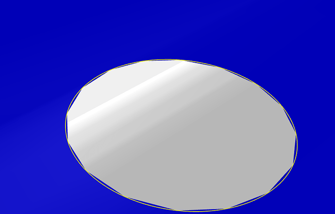

hai , i would to ask, why when i trim a circle, the result seems to have the leftover that is not being trimmed ? How do i solve this ?
I assume that this is just a rough rendering mesh, which you can make more dense from the Rhino options > Mesh > Smooth and slower.
You may want to run the ! _RefreshShade command just in case.
If you still have troubles, another possibility worth trying is the ! _RebuildEdges command.
thank you ! i will try !
