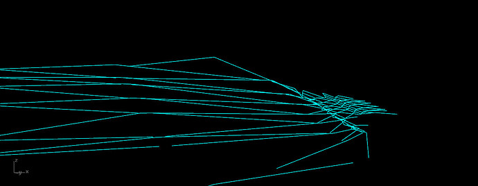

Is there a way to trim a curve quickly? I need to trim exactly 5" off a specific end of 350 curves. Unfortunately, each curve has a different rotation. I tried dividing the curves into 5" intervals which works but leaves me with a lot of extra points to delete. I’m wondering if there is a faster way to do this.
