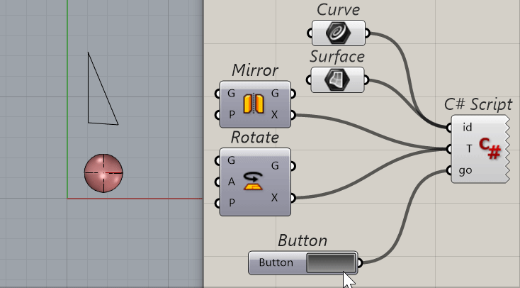

Hi all!
I tried with c#, and I’ve seen one of the problem is when you are using multiple IDs , committing a change on the first object would already retrigger the c# while it is still working on the second…
A solution: load your IDs and transformations as tree, so the c# is executed only once for each button press.
c# transform referenced geo
c# transform referenced geo.gh (7.8 KB)
Please provide same-structure and same-length trees on “id” and “T” parameters. (maybe use longest list before?)
Also, this is ignored by undo function, so beware!
Code probably can be tweaked in many ways.
