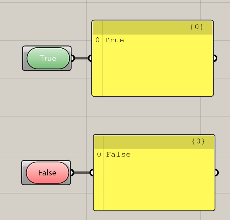

I still need a custom color for GH_Palette (from blue to green)
Hi Ben, the problem with blue area is from this 3 lines
GH_PaletteStyle style = GH_Skin.palette_normal_standard;
GH_Skin.palette_normal_standard = style;
base.Render(canvas, graphics, channel);
This is an updated version of your code.
And i need to know how we can make fonts bigger? if someone know please share.

yup, thank you, I just understood that 5 min ago:-)
here for everyone the gha file:
singleClick.gha (13.5 KB)
I dont have to render the base, but another rectangle…
I admit your solution being way more stylish than mine, but I prefer keeping the style alike :wink:
yay! good teamwork, I guess you can mark that as solved.
EDIT: Thanks for the probs, but I haven’t done big thing except for struggling and learning, haha!
Thank you , i still wait to know how to use green color because toggle generally use this color :slight_smile:
And the door is open to more solutions
You can share the result in food4rhino because the last one is your code , i am sure this will help many people.
Just one thing, when i save a file with Toggle = True, and open it again i need to click two times to change it to False
this happened only with True enabled
The reason i choose this style because it is easy to move the component and the Checkbox looks better than click.
I think because selected state is using green…
Thanks Ben, the solution is to set bo value.
Thank you @benedict for your time and your help. finally this is the component Toggle and i hope know how to change the color from blue to green.
The change of the color is simple :smiley:
I like this version with highlight but the problem with the white corners
color = Color.GreenYellow;
GH_Capsule buttonb = GH_Capsule.CreateCapsule(button, GH_Palette.White, 16, 0);
buttonb.Render(graphics, color);
buttonb.Dispose();
Toggle.gha (11.5 KB)
I try this but i don’t see any change
How to use HighlightShape and OutlineShape?
GH_Capsule buttonb = GH_Capsule.CreateCapsule(button, GH_Palette.White, 16, 1);
buttonb.HighlightShape.AddEllipse(outline);
buttonb.OutlineShape.AddEllipse(outline);
buttonb.Dispose();
nice findings @anon39580149 !! thanks!
for the highlights:
you need to empty the highlight settings before adding a new shape:
I guess outline is a rectangle in your case:
cap.HighlightShape.Reset();
cap.HighlightShape.AddEllipse(new RectangleF(Pivot, new SizeF(ButtonSize, ButtonSize)));
or even better:
capsule.HighlightShape.Reset();
capsule.HighlightShape.AddPath(capsule.OutlineShape,true);
            capsule.HighlightShape.AddPie(button, 180f, 180f);
works pretty well for round buttons:
singleClick.gha (14 KB)
