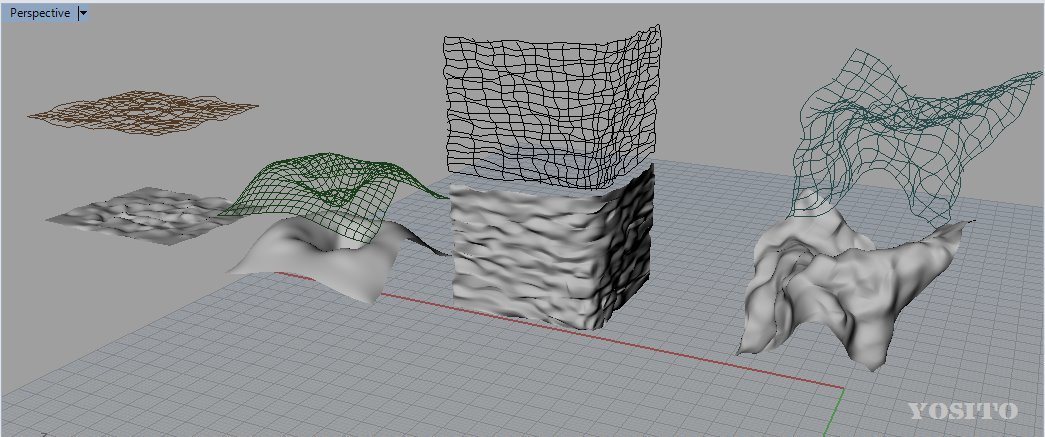

what I want is to achieve the same as in the gif that a particular area is selected to work without deforming the whole object.

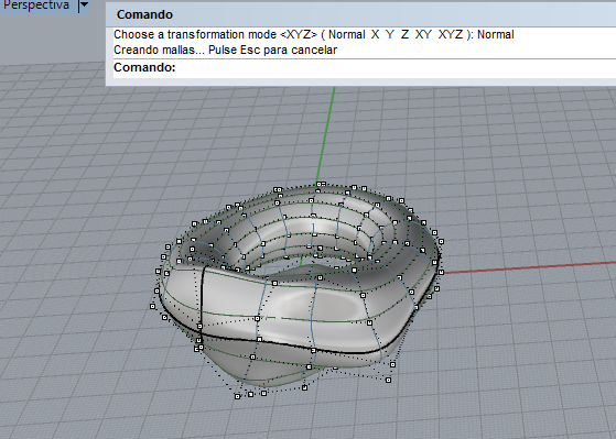

@vikthor, this should work if you turn points on and select only the grips (control points) in the area you like to deform. The script then still asks for the object and starts deforming the selection. Do you see something different ?
c.

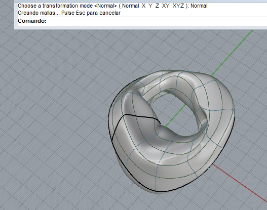

@clement
this is what I have achieved so far,
not let me option to select control points
and I can not equal deformation in the examples
It is more rigid
trying to match the example with the same number of control points, I can not get the result
Yes i see now. You have to pre-select the controlpoints you would like to deform, then start the script, then it asks for the object. To get the same deformation direction as in the script from Jess, use the XYZ option.
Any better now ?
c.
