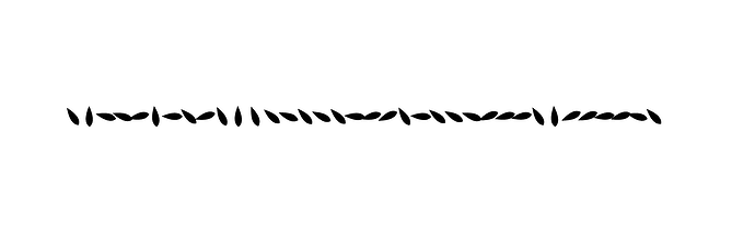

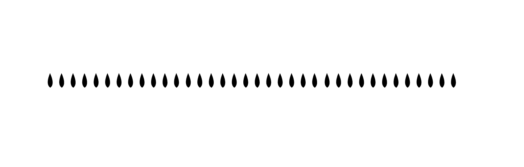

New BoxEdit in Rhino is now much faster - really enjoying it.
It would be helpful if it had an option to edit by a random value. For example, rotate all selected trees by a random degree.

Hereās a script or two that might helpā¦
RandomRotateObjsCPlaneZ.py (1008 Bytes)
RandomScaleObjsCtrPlane.py (1.5 KB)

With the rotate script; it ranges from 1 up to 180degrees.
Perhaps it could range from 0 to plus or minus 180degrees so that it doesnāt always shift to the left and can simulate full random rotation?

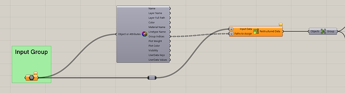

Perhaps the icing on the cake might be if these scripts could treat individual objects separately; or when grouped, as group instances?
In grasshopper, one can reconstruct the group index using Human

Actually, there is no limit, the values presented are just the defaults which are set at 0° (no rotation) and 180°. You can actually enter any values you want at the command line. If you want to change the defaults, you can change the two values in the script:
if "RROCPZ_Min" in sc.sticky: prev_min = sc.sticky["RROCPZ_Min"]
else: prev_min = 0.0
if "RROCPZ_Max" in sc.sticky: prev_max = sc.sticky["RROCPZ_Max"]
else: prev_max = 180.00
Note, if you leave the minimum at 0 and change the max to 360° for example, it will have the same result as -180° to 180°ā¦
I can look at groups at some point.

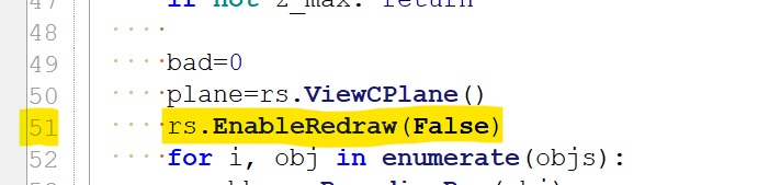

Iāve been getting this message when using the RandomScaleObjsCtrlPlaneNU script, and not sure why itās happening. I downloaded the one on this forum to the desktop, and ran it straight from python script, but got this message.
Hang on, Iāll have a look⦠V7?
Thatās odd⦠Line 51 is this:
The error message doesnāt make sense, this is a completely standard function. Are you running it via ScriptEditor in V8 by any chance? I am testing here in V7 and it seems to work fine. Also seems to work fine in V8. Is this happening with any file/collection of objects, or with one particular file? Can you post an example?
Thanks for checking Mitch.
I just opened a new file, and it worked, even with blocks.
When I did it previously, I copied something from the working file over to a fresh file, and it didnāt work. But when creating them in a fresh file, it worked.
Curious as to why thatās the case
Either way, I will try to get it working in fresh files from now
-Jeremy
If you run into a problem file, you can post it or send it to me by PM, I will checkā¦
