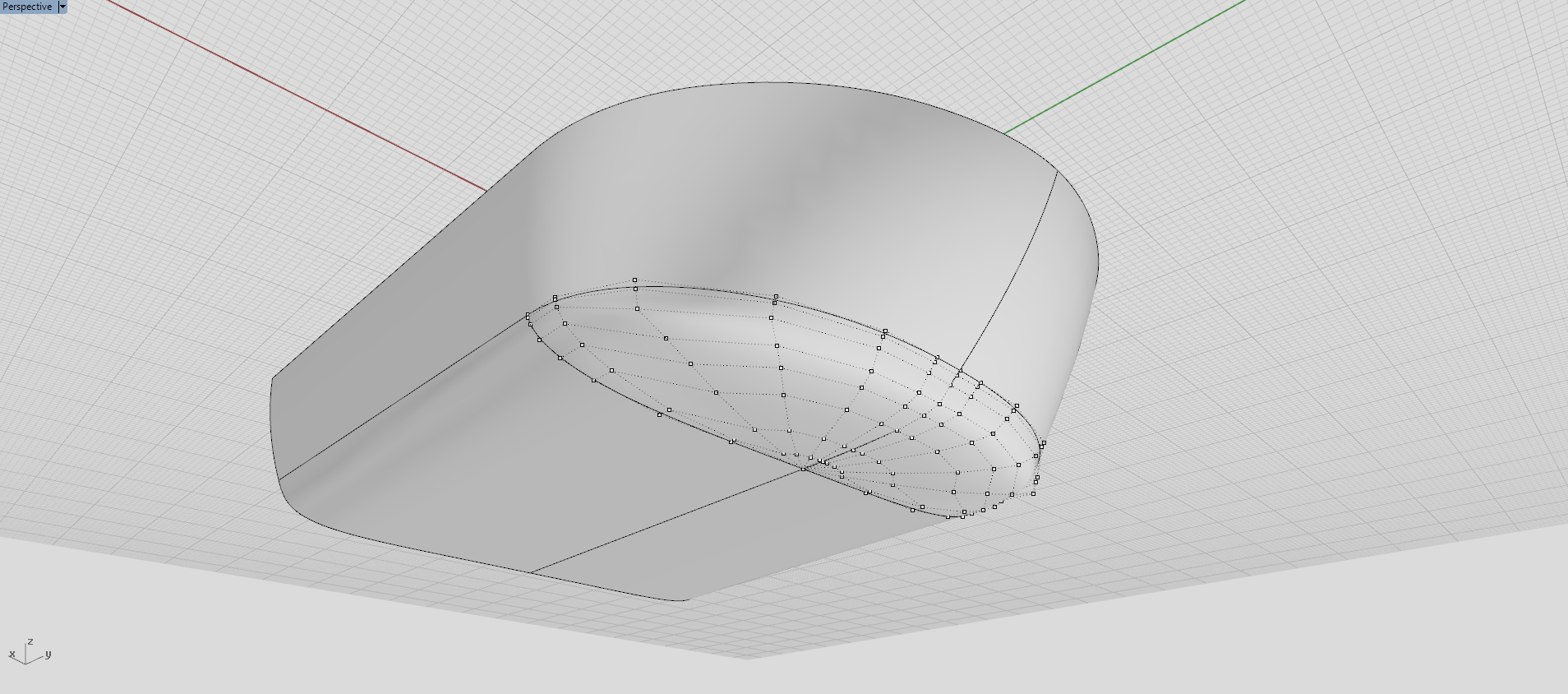

I have another polysrf that is giving me problems. I have a feeling that it would better to rebuild the thing before thickening it, but this might be a good learning opportunity. No matter what I do the hole in the model does not want to close. I’ve tried sweep2 and patch and neither seems to work. For some reason the edges just don’t want to match up. What is your strategy for a situation like this?
160517 Temp.3dm (942.5 KB)
If you were to remodel a surface like this how would you do it? This is my intent:
Hi Lawrence - I’d put the singularity at the other end of that roundy surface - hold on a second, I’ll make an example.
160517 Temp_PG.3dm (262.8 KB)
How did you make that surface? Was that a sweep1 with sections that converge at the singularity?

That would work as well… because I like to keep things simple and all three shape curves have the same structure, I lofted them first, then MatchSrf for tangency back to the straight surfaces, then for Curvature around the curved edge, with a dose or two of InsertKnot > Automatic before that last operation to give it enough points to line up ok along the edge.
The main thing is that singularity where all the points converge is at a much more convenient location.

Hi Lawrence - I guess I only matched for tangency at the front edge - the sides are only tangent to the bottom.
http://screencast.com/t/Al6ziqmrk
Thanks @pascal. I followed your instructions exactly and it worked.
I didn’t realize that you lofted from the flat piece to the middle curve and then back to the flat piece. I first extracted a few isocurves (u shape same as bendy piece) from the old surface and then lofted from the bendy piece to the isocurves and then to the center point. My problems after offsetsrf stemmed from the singularity. I wonder why your singularity did not cause problems but mine did…
Seems kind of strange that you can do similar things to get similar resultant surfaces, but only one process’s surface is actually offsetsrf-able.

I went back yesterday and remodeled the original surface so that it has better curvature. I still have that singularity, but it’s causing me issues when I offsetsrf. I eventually remodeled the problem surfaces (after the offset) and got a closed polysrf, but I’d like to know how I should handle the singularity in the future. Would you ever trim the singularity and try to patch it with another small surface?
160518 Temp_1.3dm (339.4 KB)
Hi Lawrence - the two halves are not tangent along the centerline - that will mess things up.
and the singularity is not very smooth:
160518 Temp_1_pg.3dm (137.7 KB)
I don’t get it. I did matchsrf on every edge, but it would never fix the singularity. Which command did you use to fix the singularity? Zebra seems to pinch at the singularity no matter what for me. Is this a tolerance thing?
I noticed yesterday when I offsetsrf with a tolerance of .001, it would produce a open polysrf, but when the tolerance was .01 it would create a closed surface. Why do some commands not operate on the tolerances set in the options menu?
Nice hack, but “best practice” modeling would be to avoid the singularity all together, which shouldn’t be too difficult in this case.
