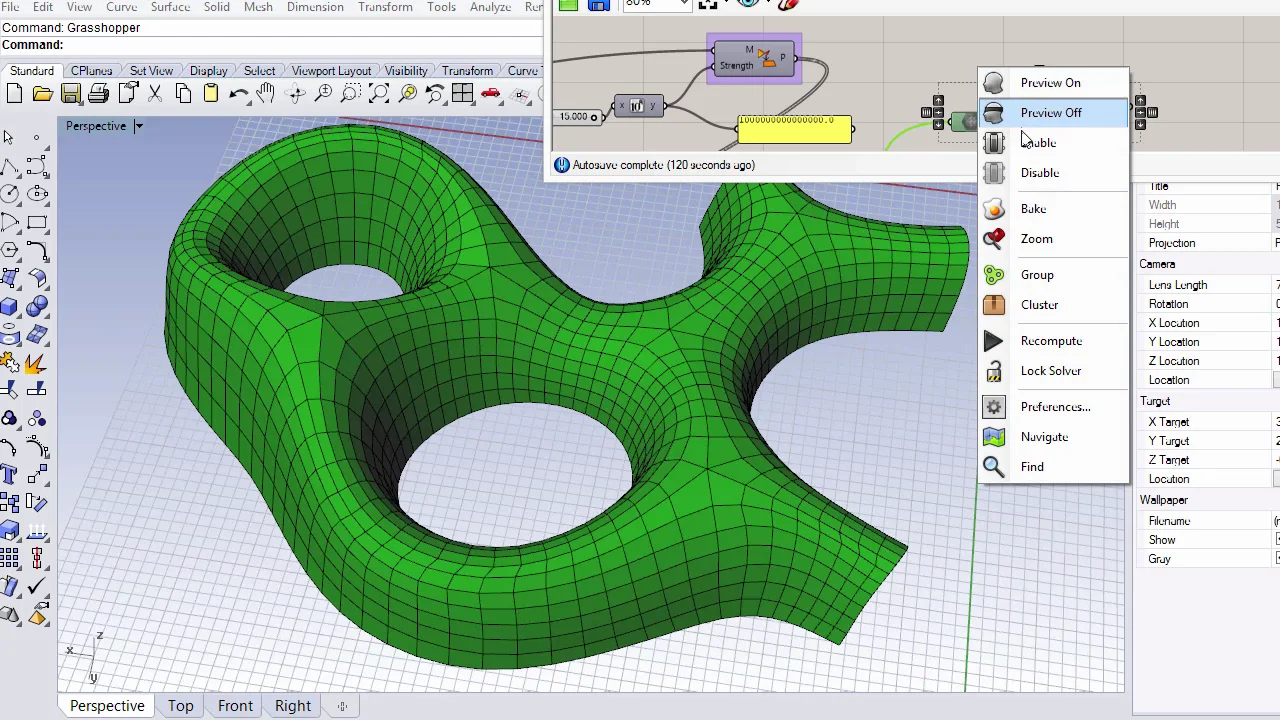

I’m making a tensile skin model in which I want all panels to be plain flat/rectangular. How can I do it? I tried using coplanar component but the process doesn’t give fruitful result.

I would suggest to use Rhino 7 WIP QuadRemesh command since Kangaroo won’t remesh your initial mesh to quads and Brep to Mesh won’t generate only quads either.
I ran QuadRemesh with 1 as target EdgeLength on your surfaces and brought it back to RH6 after that. Is that what you are after? The picture shows only the starting mesh before relaxing.
Thanks for the quad remesh advice. Definitely some progress now. As I mentioned, I would like to have all quads as flat/rectangular ones, not quads. I have reached here. Some quads turn out to be flat (highlighted in green), the other ones aren’t flat.

You have two meshes there. Join both surfaces to a open brep before using quadremesh.
Cool! Done! Very neat output! Thanks a lot. ![]()

You generally need some other goals along with the planarization to keep the mesh from distorting too much. I’ve made many posts with examples of this, such as this one: About PQ Mesh, conjugate curvature network
Also be aware, not all quad meshes can be completely planarized.

@DanielPiker , in an era when quad remesh feature wasn’t available in Rhino, how did you model such neat double curved forms consisting of quad geometry? Did you use some other software for building the original form?
There’s a similar example file for the current version here:
https://github.com/Dan-Piker/Kangaroo-examples/blob/master/grids_and_mesh_optimization/Planar_quads.gh
