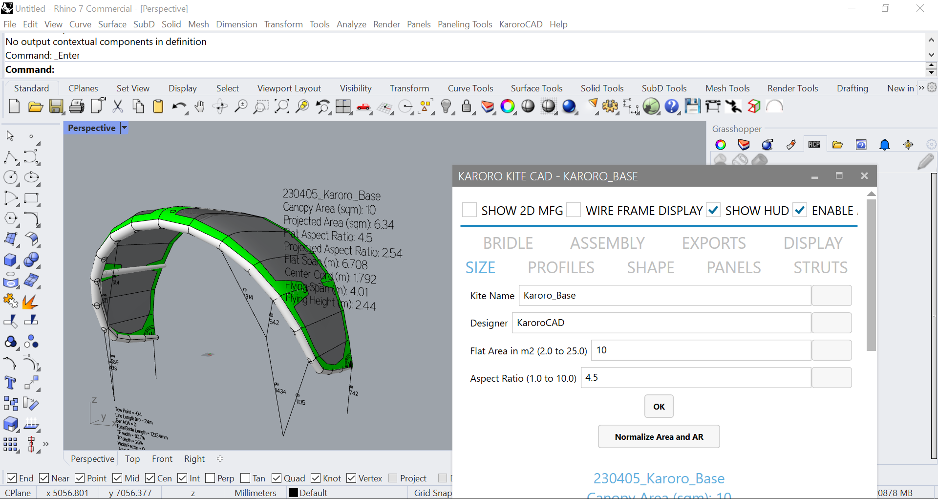

I’ve got a suit of tools here written in GH with a HumanUI user interface that I’ve compiled into a Rhino Plugin, complete with menu items etc. In this approach the user has no access to the GH file and would just need to ignore the rest of the Rhino controls to run your app.

Would you be able to share a screenshot of what you managed to do, please?
Does it have an interactive viewport where I could draw lines and such?

Hi Mate,
Mine looks just like yours above and is 100% parametric from the HumanUI, Rhino is really just used as a display.
In saying that is it possible to draw on the rhino canvas, I just dont pull any of that data into GH for processing.

Hi, bravo about the app, looks super cool, I am more of a longboard guy, but hey, cheers for that tool you made.
On the thread subject… It seems you did not take it out of the Rhino environment, and since the app doesn’t need any graphic input, you could actually create a 3D window within the HumanUI interface…
