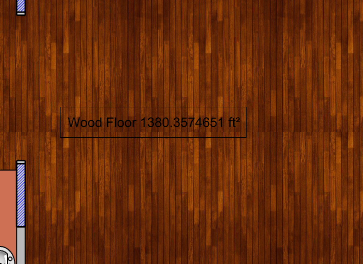

I made a tag to show the slab style and area, but there are a few things I would like to add to it that I am not sure how to do;
  1. I would like to add a background to the tag so it shows up better
  2. I would like to round the area calculation to one decimal point
  3. I would like for the are to be below the style, instead of to the side
This is the format I used for this tag %<element.style.name>% %<element.area>%
Is there a way to put this in a tag automatically without have to paste it in the format each time?
Any help you can offer would be greatly appreciated. Thanks!
