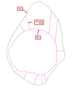

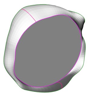

I am trying to implement the use of a Sweep2 operation in a plugin that we are writing. When I do the operation while manually selecting the curves in Rhino, the operation gives a nice result:
In our plugin I first tried to use the Brep.CreateFromSweep() method, but that gave very unsatisfying results:
When using the SweepTwoRail class as is mentioned in the Brep.CreateFromSweep() documentation, I always get an empty Brep back.
Does anybody have any idea what I am doing wrong?
Here is the code that I use to test this functionality and the 3dm file with the actual curves :
allcurves.3dm (42.5 KB)
