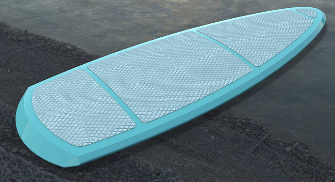

 I finally worked out how to make the grip foam pattern using an image and the bump channel. This should be lean and clean by not having to model and render every little nook and cranny. See how this looks and I will add the 3dm file with the bitmap I used. I can see now when tiling that diamond pattern that it is not seamless but I can crop it to deal with that.
Thanks for replying. Yes I think if you cropped the picture better you would get a seamless tiling.
It’s obviously tiled though due to the tonality differences in the different edges that meet up.
Certainly a lot lighter though.
I’m needing to do some close-up shots for advertising and maybe some “fly-by” movies and I really think the actual geometry is needed to sell this so they light is just right.
There must be a way to lighten this up. Maybe this nee SubD stuff??
I may try to make a BLOCK with just two diamonds and see if I can array that and perhaps it is the solution.
I’ll post a screen grab later if the kind of closeup I’m trying to do
I have sorted out the tiling issues and scaled down the pattern to what seems appropriate. What do you think?
Non Skid Foilboard deck.3dm (901.0 KB)
Looks a lot better! The tiling worked great. I am just sitting down to see if I can use the block feature to help this. The fact that the foam is pretty matte helps the fact that you can’t get (I believe) reflectivity in the tiled picture that you would get if using a 3D model.

Hey, the block thing works awesome. Went from 200MB file to 3mb file!
OK this has taken me waaay longer to figure out than I thought, but here is an acceptable result. The entire model is still under 100mb
For anyone searching this in the future or for anyone who wants to chime in with more nuanced experience, what I ended up doing is modeling just two of the diamond shapes and making them a solid. I then saved them as a block, inserted that block into my model, and then arrayed the block to get the thousands of diamonds.
Then I used the top view outline shape to use the WIRECUT command to cut the diamonds into shape. Then used the same wirecut profile to extrude a thin solid that I grouped with the diamonds.
An important note is that the wirecut seems to not work unless I explode all the diamonds first.
Perhaps exploding them negates the space savings of using a block, but whatever… I finally got a workable solution. If anyone follows this and wants to comment on tweaking the workflow I’m all ears.
