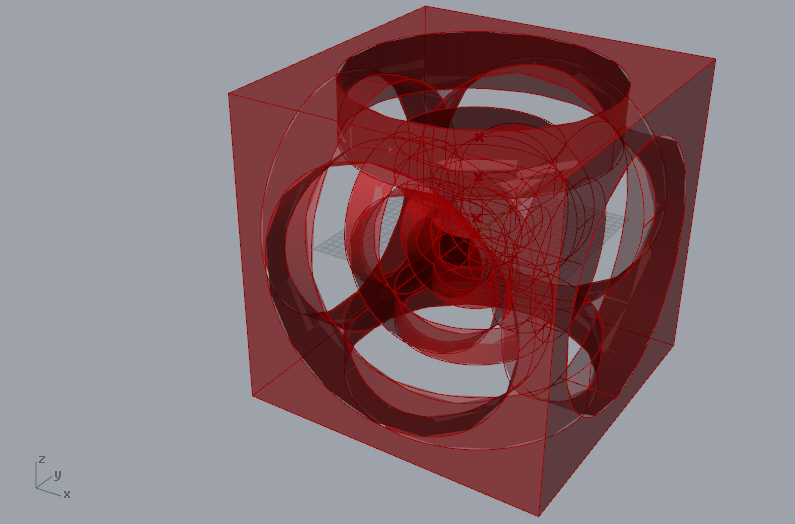

My project is to make a parametric Turner’s cube.
How to get the bases of the holes (cylinders) surfaced and rotated to complete the cube?
Will the intersections between holes show through properly?<a class=“attachment”

Here is a way of doing using shapes from LunchBox
and Anemone in order to cut one hole at a time.
It also work for all types of solid with planar face and not too far from sphere (I hope ):slight_smile:
See the magic of consecutive cut. Not very good with GIF animation

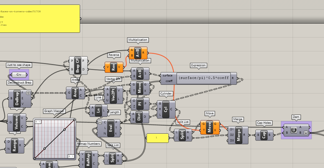

Hi Laurent,
Thanks for the great definition. I had Lunchbox, and I’ve downloaded Hoopsnake, and loaded it up. Also updated to the latest Grasshopper.
Unfortunately I’ve got nothing connected to the ‘reverse’ component at the top middle, and a gap where the ‘brep closest point’ should be. My BCP component has only two outputs P & D, perhaps this is the problem?
Best regards,
Charles Thompson.
The problem is that I use rhino 6 and GH 1. Brep closest point has been updated with a normal also. It is possible to calculate the normal as a vector from center of mass to center of face.

Hi Laurent,
Sorry to be a pest but as you’ve gathered I’m pretty much a beginner, and have very limited math.
Vector is sorted (thank you) and I’ve now got Anenome, but there’s something you have labeled as ‘incremental cut’ missing in the last group at the end of the definition…
Best regards, Charles.
I don’t understand.
If it is not working click on dam component
Calculation will begin
Sorry Laurent,
I should have attached this screen shot showing the unhappy solid difference component:
Is it something I have done wrong?
If there is no data in the [A] input of the component, then it won’t do anything.
You have not hoopsnake component
Wrong I was. You need anemone.plugin ?:astonished:
Download it and reopen the file here on this forum
Thanks Laurent,
That’s all working now and I really like it!
