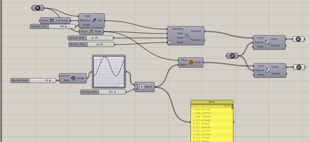

Hi everyone,
I’m sure my problem is super easy but I can’t solve it alone !
Two set of curve generated by polar array and circles, trimed by regions.
I want to make a surface at each intersections (circle / lines / regions)
rh
See the definition with internalized data :
srf_int_crv.gh (11.7 KB)
Many thanks !
do you mean this ?
Yes exactly !
I want to have all the surfaces made by those intersections.
Thanks
Split the region with the curves
Thanks to both of you !
This works perfectly !
