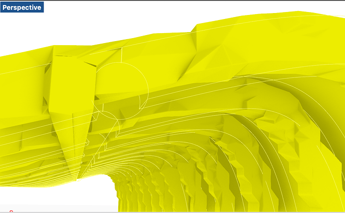

My rhino file has distorted the surfaces from being smooth.
This happened when I copy and pasted from a different file.
Any way to easily fix this ? When I copy and paste back into the previous file it is normal again.
Thank you
Thank you
Hello - most likely, your object is very far from the World origin - see
https://wiki.mcneel.com/rhino/farfromorigin
-Pascl
