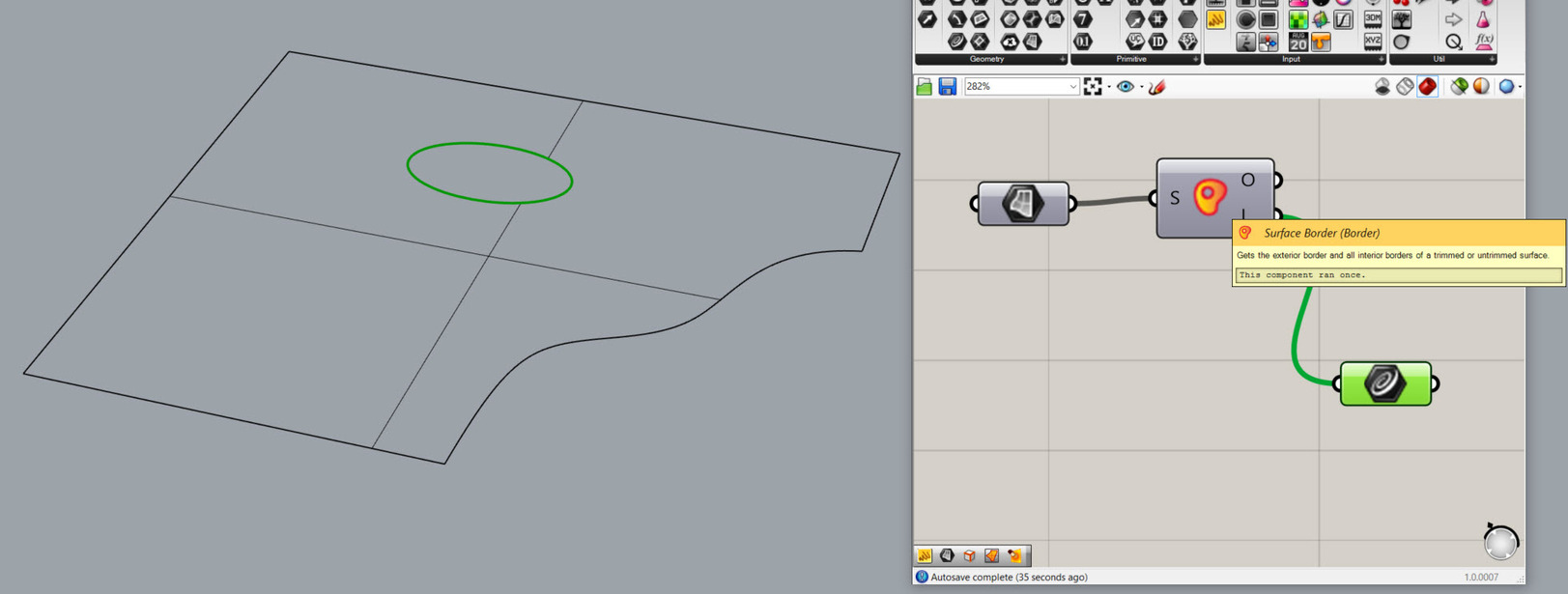

I can’t seem to find a component that would input surfaces (or BREP faces, or whatever the goddamn name, you see what I mean) and output separately the inner trimmed edges, outer trimmed edges, and possibly separate the integral and partial non-trimmed outer edges.
Aha !
I found a component that can at least separate inner and outter borders : the Sasquatch surface border component.
