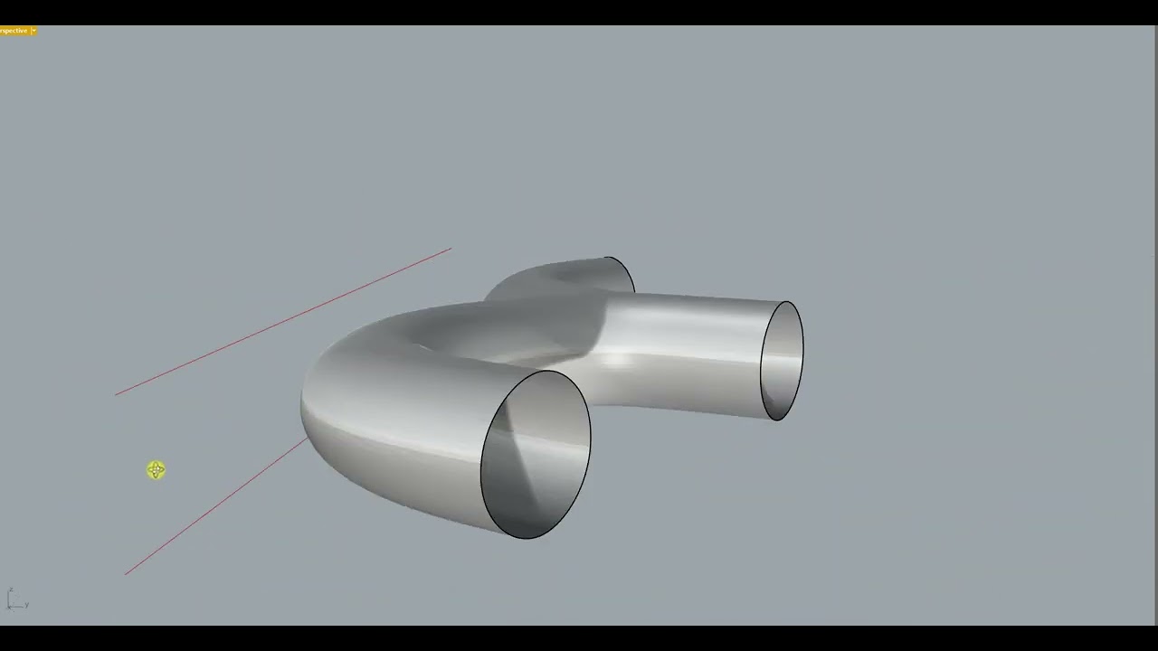

I am searching for a good way to avoid or correct the “bumps” (thickenings) that happen in SubD like shown here
the corresponding control point geometry is flat
So most likely the problem is due to the 5 edges star marked here
Sure, I can fix it manually to a certain degree - but the question is: Is there a more accurate or “correct” way - if possible some kind of “automatic” way to avoid or correct these bumps? Even a Grasshopper / Kangaroo solution would be ok. The more automatic and “correct” the better.

Example.

Dear Inju
what s the precise position of the Vertex your inseting at 0:59 of the video
@theoutside
I am not completely convinced on this solution - as it depends on this position / z-height.
And with have a “wild” combination of N5-Gon, Starpoint, Triangular Face.
EDIT:
this is the Vertex i am not convinced of:
@inju Thank you very much for your help and even creating a video. I really appreciate that.
However I have problems understanding how you set the two new vertex points - as also mentioned by @Tom_P
Is that at 25 % of the edge length (half of half the length) or is it just placed somewhere in between center and end of that edge? Sorry for being so picky on that - but as mentioned, I am searching for a solution that is “correct” as much as possible.
Sorry for my poor English.
Just a reminder, SubD is not for precision modeling.
The answer to your question, showed one of the methods
of adjusting the point by height, at random took 1/4 of
the length of the edge, for a more accurate adjustment
of the height of the point, select the position of the inserted point on the edge.
You are right, for a more or less accurate size,
the position of this point on the edge must be picked up.
The position of this point depends on the shape of the model itself.
It’s just a method, not an axiom.
Assume that the purpose of SubD is the beauty of form, smoothness, not accuracy.
The fact that I showed you this is one of the methods, I do not pretend to be true.
