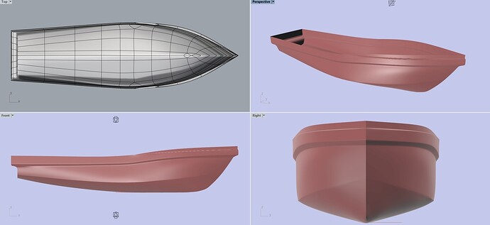

Heres one for you boat folks… A fading hull chine, and fading beltline fore/aft-
hint, I started with a side view “paper doll” and then pulled half the boat into shape before using mirror and join. Bonus if you get the fade from the front of the boat to the back on the top of the beltline.
here are more views to work with-

here is my file for reference-
edge loops do not have to be continuous, and faces do not need to be 4 sided. You can add or remove edges, or more importantly, parts of edges to allow details to fade in or out-
take a peek at this file in v7-
fading chine.3dm (176.2 KB)
Thank you. I believe you deleted a few edges towards the stern and left them in the nose. I can get something that replicates what you have done on the upper chines. I’m Interested in how you created the hull structure. The main chine is hard at the transom and fades into a smooth surface forward, but there are no edges missing. Also, there are no creases. I am guessing you created the hull with a sweep of 2 rails? And the hardness of the chine was defined by the section view?

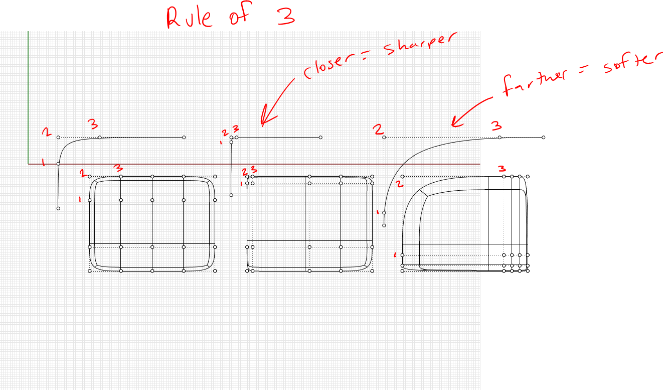

in the one I posted, the chine fades because the 3 edges that make up the chine itself are closer together at the back and farther apart at the front.
Just like a nurbs curve, corners and features are defined by three points or three edges. In my videos I refer to this as “rule of three” It takes 3 points to make a nurbs curve corner, and as such takes 3 edges to make a subd corner.
see if this helps-
I talk about rule of three is several videos- this one is a good one to watch. 12:15 is where I talk about this.

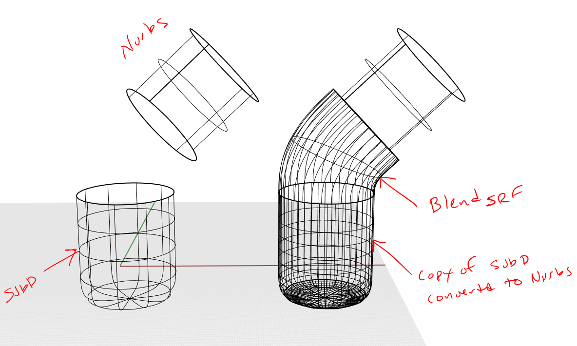

remember, use the right tool for the job… Subd for the swoopy bits, and nurbs for the sharp detailed bits, and a combo of both when appropriate.
Remember you can always use a blend surface between a converted subd and a nurbs obejct .
I will take a subd, convert tonurbs but keep the input object then run the blend, and then delete the converted nurbs object. That way I can keep the subd but transition into a nurbs object.
Ideally we could blend between a subd and nurbs without this sub step…hopefully in a future release.
