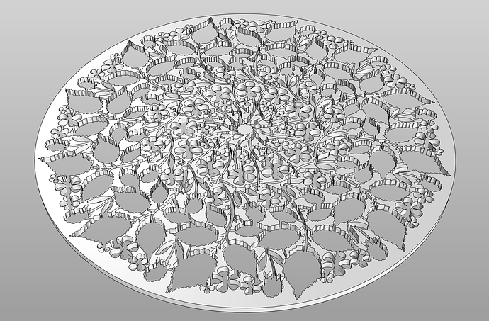

When I try to extrude a drawing comprised of multiple (1000’s) small closed curves within a perimeter closed curve (sort of like a colander!) I’m experiencing a problem where the outer perimeter curve extrudes as a solid capped shape thus obscuring all the (also) extruded smaller shapes…meaning you cannot see the holes cut out within the overall shape. I have done exactly the same on many other drawings without any problem, but for some reason this one won’t behave! Any clues as to why.

I get the behavior you describe with Rhino V5.5.4
It works as expected with Rhino Version 6 (6.19.19266.14182, 2019-09-23)
Also works as expected with the Rhino Version 7 WIP (7.0.19267.12036, 2019-09-24)
Spinning beach ball for about 30 seconds on V6 and V7 WIP while processing ExtrudeCrv command - not surprising, it’s working with a lot of geometry (2392 curves). At the end, the result is as expected - a solid extrusion with holes cut out for the smaller internal curves.

Looking at your file some more and I think I’ve got the result you wanted:
Steps I followed:
  1. Open your file.
  2. SelAll
  3. Fair with Tolerance 0.1
  4. ExtrudeCrv
The Fair command alters your curves slightly, but at the scale of this model you have to zoom in a lot to be able to see it.
I tried this with Rhino V5 and it seems to work there as well.
Just curious - what is your workflow to generate these curves? You’ve produced some nice designs.
-Kevin
Thanks Kevin - at last that did the trick! Ive tried it on other curves that didn’t work, and by adjusting the Fair command it seems to sort it out. Out of interest, why would using the Fair command help this to work?
