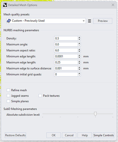

Kyle Houchens had said to use his settings to mesh it,
but I am not able to if its meshed in Prusa. as I dont see p[topns to alter numbers within.
and I was told to export from Thino V8 as step, ā€˜prusa ok it’ then export as stl from prusa.

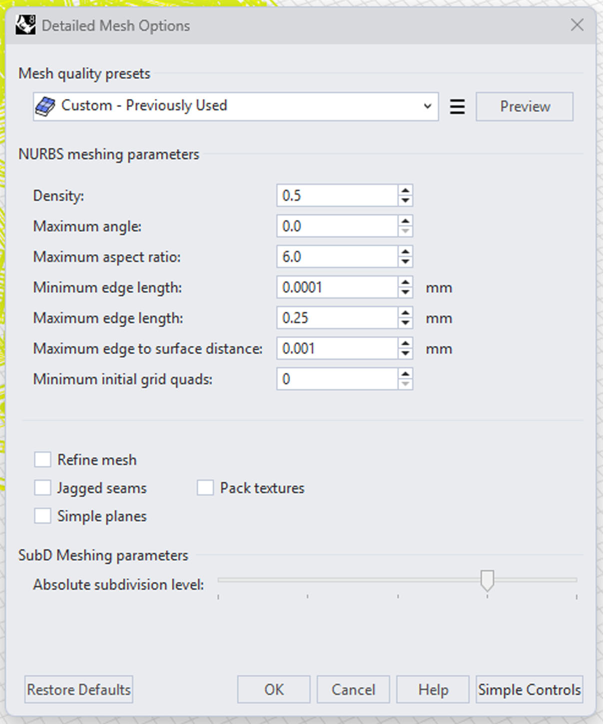

and also I was told to mesh it in Rhino using the settings I post above. given my by Kyle, who sent me the file personally.
I had been following the Rhino route of check its watertight etc, then mesh it, but then AnyCubic slicer was declaring it faulty, so the step route was suggested to solve things.
It all got very confusing at times.
Ok , I will mesh it in rhino with Kyles settings, then check it in prusa.

Kyle Houchens McNeel says…I’d mesh it with these settings,
then run triangulatemesh to detail it a bit further (some printers don’t like quads)

export as stl, using KH settings,
then import it, and run TriangulateMesh on it. I see nothing happen. has it ?
Here is the file and the rhino8 made stl file using KH settings,
and with it the prusa stl export, note the very different triangles for large flat areas.

The difference I see is the Kyle mesh has no simple planes.
I don’t see the point of your separate triangulation. I think an *.stl is always triangulated.
