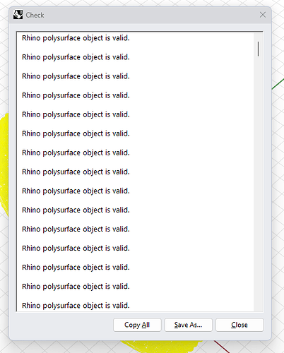

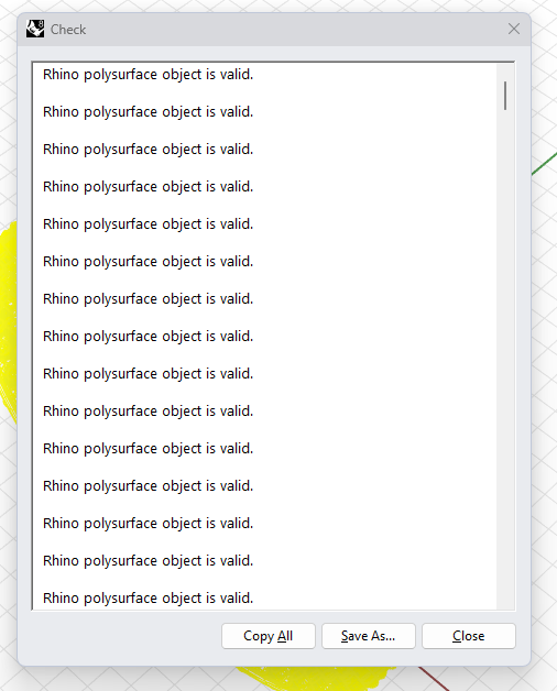

check is a simple command that lists very simply, whether a part is good or not-
I use it to quickly ID anything that is amiss.
since the sentence “rhino polysurface object is valid” is repeated for each object and is all the same length in the dialog, you can whip down the list quickly with the scroll bar and it’s easy to visually notice if there is a different length sentence… that tells me there is something to dig into.
then I jump into selbad, selopenpolysrf, etc…

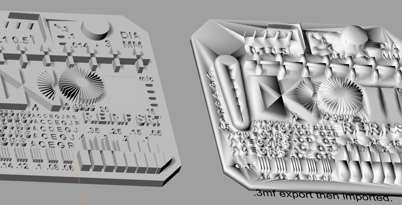

I also try .3mf which I gather is the ‘latest kid on the block’. I see no option to enter a size.
Here is what it looks like imported back into Rhino8.
A MESS.
Steve
may want to mesh you part 1st before you export 3mf.
sadly that export does not appear to have any meshing options so you get whatever Rhino gives you.

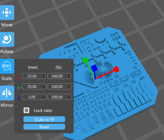

I’m not really following why you need all these steps. You’re starting with an STL file - just drop it into your slicer and print? The only time I take an STL into Rhino is if I need to modify the part.
As for regular nurbs geometry again - I don’t see the need to mesh then export as an 3mf. You can omit the meshing part and just export your geometry to STL or 3MF.
Here’s the STL from your first post dropped right into chitubox - it’s the correct size. Nothing needs to be done in Rhino.
