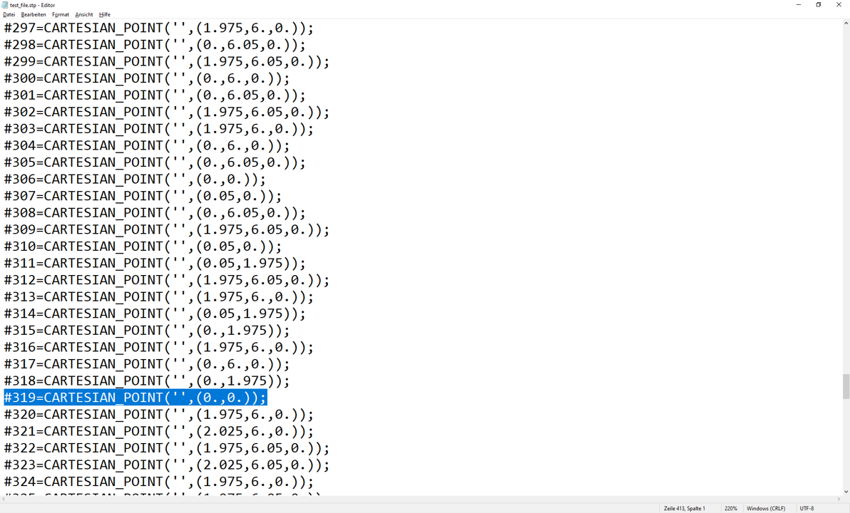

I have exported a surface geometry to a step file, but there are some coordinate components missing. Is it supposed to be like that?
I have chosen the STEP Scheme: ‘AP203ConfigControlDesign’, with the option ‘export parametric space curve’ selected. as I need to have the information ‘B_SPLINE_SURFACE_WITH_KNOTS’.
Thank you.

The points with 2 coordinates are 2d points, associated with trim (2d) curves. You can work backwards through the id numbers. Start with your example
#319=CARTESIAN_POINT(‘’,(0.,0.));
Search for #319 and you’ll find
#144=B_SPLINE_CURVE_WITH_KNOTS(‘’,1,(#318 ,#319 ),.UNSPECIFIED.,.F.,.F.,(2,
2),(-1.975,0.),.UNSPECIFIED.);
Search for #144 and you’ll find
#80=DEFINITIONAL_REPRESENTATION(‘’,(#144 ),#417 );
Search for #80 and you’ll find
#60=PCURVE(‘’,#197 ,#80 );
Search for #60 and you’ll find
#100=SURFACE_CURVE(‘’,#143 ,(#60 ),.PCURVE_S1.);
The last object is the trim curve. You can keep working backwards and the further you go the higher up in the brep topology you get.
I hope this helps.
