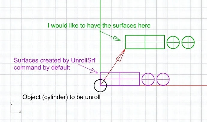

It seems to be that surfaces created by UnrollSrf command are placed on Top viewport from 0,0 World Top CPlan. I have a question. Is this any possibility to “tell” Rhino 5 where these surfaces should be created? (see picture)
I would like to change the starting point for these surfaces because these surfaces are created at the same place where other objects are and in many cases it is very difficult for more complicated projects to select or modify these new surfaces.
Just made this for you. Install this plugin for your rhino.
2 commands:
Unrollsrf2 - like the normal unrollsrf but then with movement edit
Unrollsrf2edit - a popup opens and asks for the position to move to. He moves from w0,0,0 to - Your position. :smile:
You dont have to unrollsrf2edit every time you use it. It remembers last time information that you told him :slight_smile:
So unrollsrf2edit is for editing the position and unrollsrf2 for the command.
UnrollSrf2.rhp (19.5 KB)
