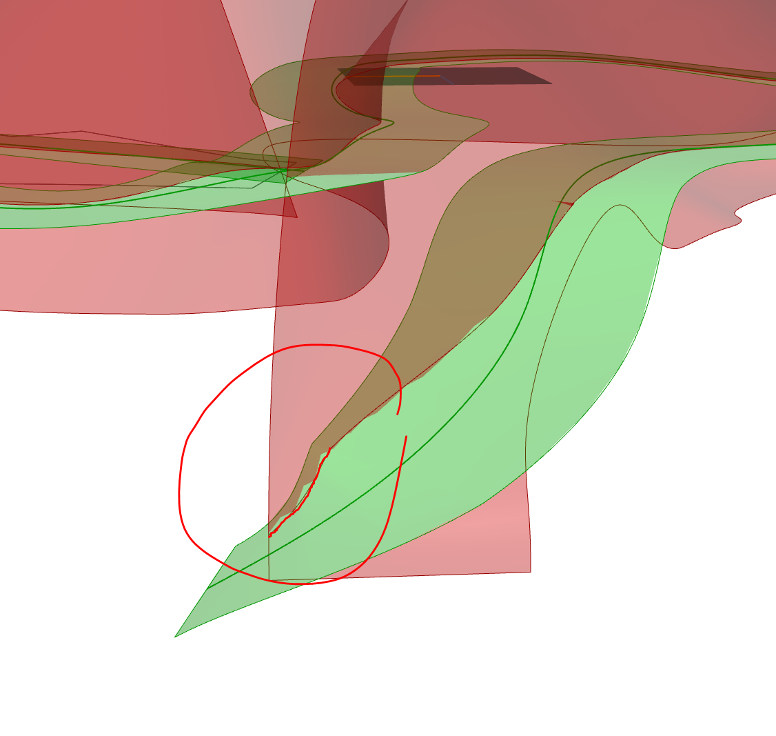

@LeGaulois,
Your surface has certain regions that will inevitably complicate pulling/offsetting/splitting/trimming, mainly here:
Also, your selected curve doesn’t fully intersect the surface you want to trim, so you’ll need to make sure it does and also extend it past the edge of the surface.
It’s best to correct this earlier in the modeling process.
In the meantime, I’d move your curve up past that problematic region and try to use Pull Crv.

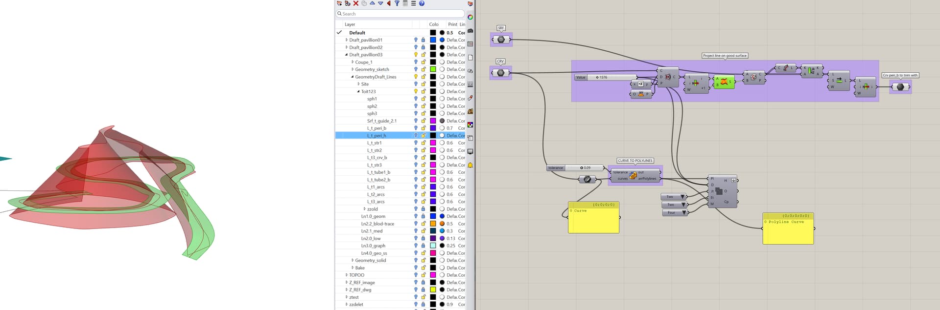

Hello @René_Corella, I remember why I went away from the “pull curv” to surface technique. Somethimes it creates wierd things… and I don’t know exactly why. Maybe you could enlighten me on this ?
  • the curve projected is this :
  • And the pulled curve result in this :
** In my main gh file which is EXACTLY the same definition for this part as the .gh file I provide down here, the pull curve mess-up. (I don’t get it, I internalize the srf and the curve and they are exactly the ones I put in the .gh file down here… but pull curve result differ..)
and the file size is too big… 23mo…. (20 is max)
Also your srf 1 take 10 sec to split, while srf2 takes 4 min…. ?!?..

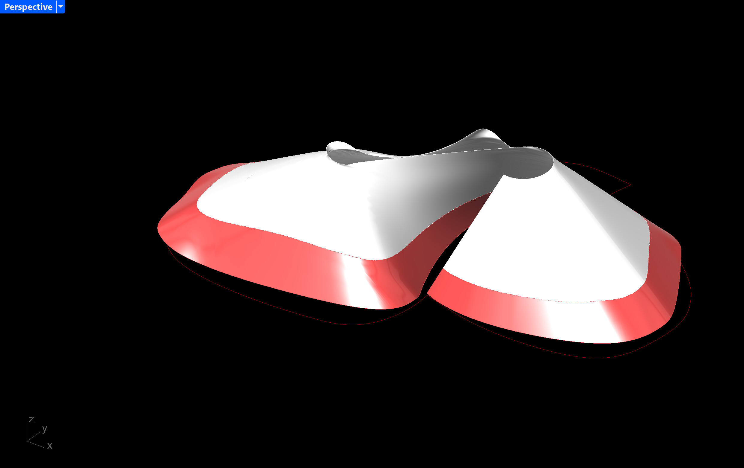

this is the orginal shape made with SubD.
Now I have to “understand” this shape for its construction (this is architecture btw, not for an object design, so structure constraints are majors)
There are 3 parts to support this structure.
3 supported cones (the supports are easy, not the main prob here)
extended for later major trim
trimmed
Connected with blendsrf (unexistant component in GH yet…). Master Srf ready to trim with Original SubD Top and bottom curve.
So the challenge is getting as close as possible to the original design SubD shape but adding to it the reality of construction. And from there many recipes are possible ofc.

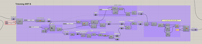

Summary:
DrawCurveOnSrf_RC1_CC2.gh (11.2 MB)
Generate the fake “unrolled” version of your surface, interpolate the curve on-surface, map it back to 3D - the trick is that the curve information is first obtained from your 3D curve via the IsoVist Ray in order to skip unprecise pull method and rely on projecting curve points:
