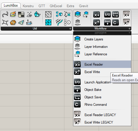

I using LunchBox Component
There is no attachment. I don’t want an Excel file either. I don’t want to install LunchBox to get an Excel file reader. From the second image you posted, this is about much more than splitting a list of numbers. I don’t know what to say anymore… Time to take a long break from the Grasshopper forum I guess.

LunchBox extension can download here
Hi @duchoabn, the problem is not that it’s impossible to install a plug-in like Lunchbox, but rather that it’s a lot of work that seems irrelevant considering the scope of the question.
