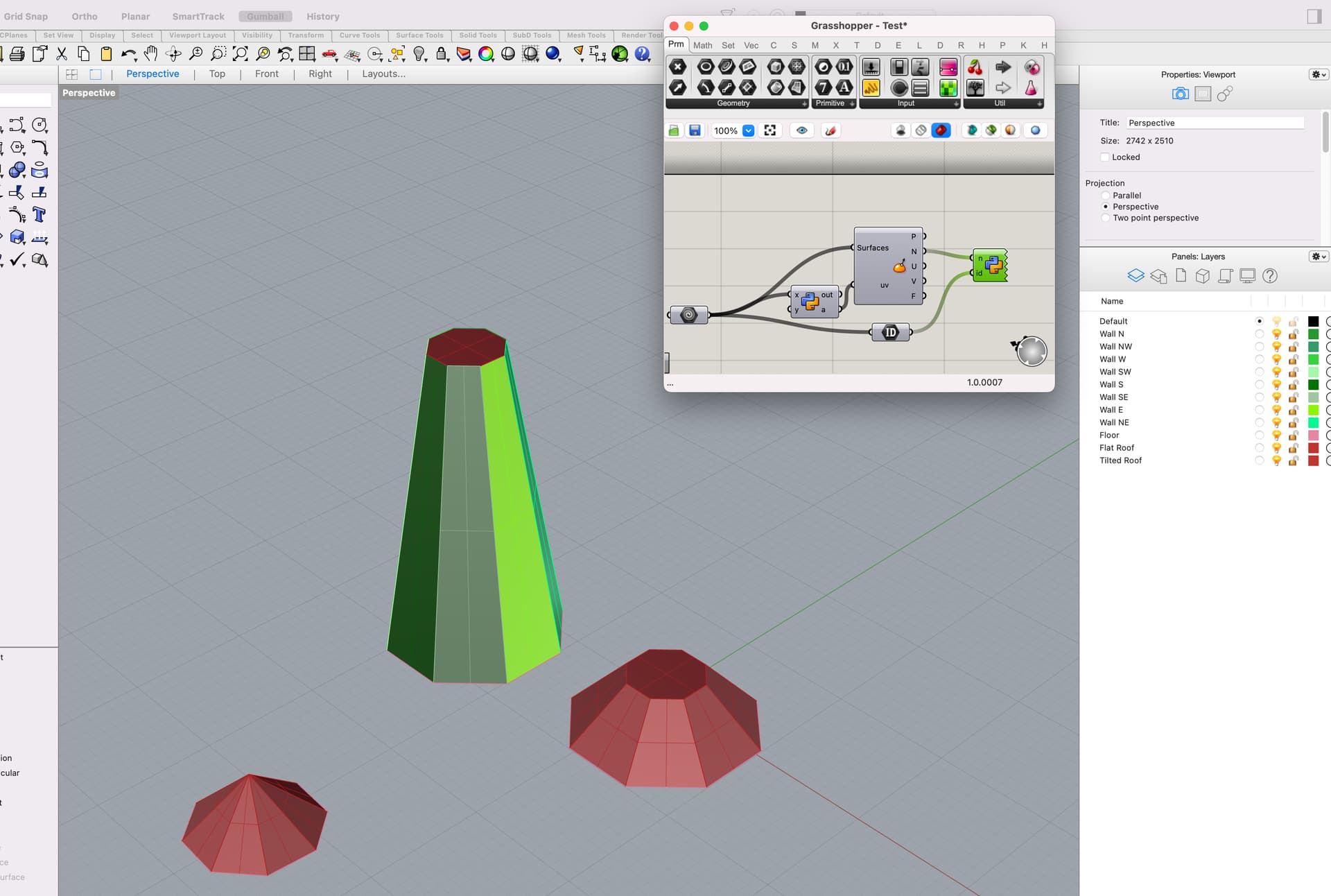

Dear Pascal,
I am still working on this component and would like to optimize it even more. However, I am facing some struggles and I cannot find the problem with them:
What I imagine is a Check of an entire geometry and the distribution to layers, as we discussed before. The extension shall be the distribution of surfaces to the “Flat Roof” “Floor” and “Tilted Roof”. However, depending on the angle of my tilted roof geometry, the python script puts the surface either on the wall layers or the roof layers. I do not know how the height is influencing this issue.
Do you have an idea?
Would appreciate it a lot.
Best
Maximilian
Test.gh (6.1 KB)
This is the layer name and vector information extracted from your script:
As you can see, the vectors you have defined for your “Tilted Roof” layers all have theta angles (slope or pitch values) of either 45° or 35.26°. If your roof surfaces aren’t created at one of these slope angles, you are going to get unexpected results.
I have re-written your file using standard grasshopper components. The GhPython Script component is still used but only to create layers and to move the surfaces to the appropriate layers.
orientation_Test_kr.gh (33.2 KB)
-Kevin
Thank you very much Kevin, it works perfectly.
I am wondering if the same achievement could have been done with a modification of the Python Component only? For example that the component has to check if the surface normal is within a certain degree ratio? I thought that a Vector3d(0,0,0<1) would search for all vectors that are 0 in x and y but have a tilt in the z direction. But I guess Python cannot read it like this right?
Don`t get me wrong here. My entire Grasshopper Tool will become very big and I try to reduce the amount of visual components to a minimum for better overview and understanding.
But if you think this cannot be achieved in a Python script just let me know :slight_smile:
Sure, give this a try and let me know if you find any problems:
orientation_Test_kr.02.gh (5.7 KB)
-Kevin
it works perfectly thank you so much!!!
