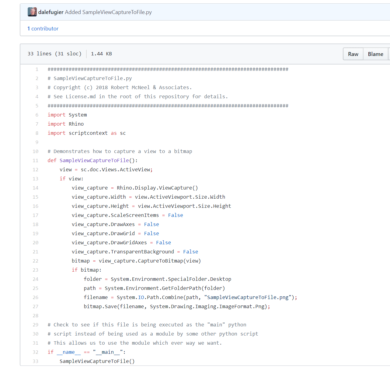

edit: add your view capturing as you like. See https://github.com/mcneel/rhino-developer-samples/blob/6/rhinopython/SampleViewCaptureToFile.py for nice python-y way of doing that.

Hi @nathanletwory,
I wanted to add this tool to our scripts /workspace so we can output screen captures to file that match the names of our snapshots.
Right now I have a really dumb manual/macro way that can only restore a predefined list of snapshots names. So getting this approach to work wold be a lot better.
I know you mentioned that we can “add your view capturing as you like” and linked to a scrip from @dale, but I have no idea how to incorporate this.
I’d like to have a macro when I can be prompted a folder location and write put all the snapshots as .pngs to that folder. And have a place in the script where I can replace the pixel height and width that I want for that viewcapture to file.
For example, when I look at this code below:
…I have no idea where I have to put the resolution that I want, like 1920x1080 for example.
Also this script most likely will overwrite .png files with the same name on that folder, since the whole point of this script is to update .pngs after a design/rhino file change, so all the documentation with screenshots about that file get updated, and our Indesign documentation file gets updated with new linked .pngs.
