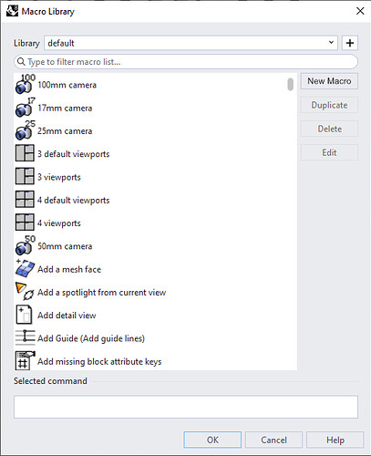

Whenever I want to create a new macro library, I instinctively go to Window > Macros... to open the Macro Library dialog only to discover that the Macro Library Dialog doesn’t allow me to create new macro libraries, which is confusing. I think right now the only way to create a new macro library is through an indirect process (ie, create a new toolbar and add at least one “new” command to it).
If it wouldn’t be too difficult to do, I would like to see a New Library button of some sort in the Macro Library dialog, which would create a new empty library. This could be a little + beside the library drop-down or a New Library button.

I guess instead of a New Library button, we could have a New Toolbar button (and rename the dropdown from Library to Toolbar (since it apparently is actually a drop down of toolbars)?
Again, if it’s too complicated or too likely to break things in the toolbar ecosystem, then I’d rather not have the change, but I’m hoping it’s just renaming one button and adding a new button that calls whatever command(s) that File > New in the Toolbars option dialog calls and then refreshes the drop down so the new toolbar appears there.

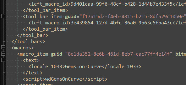

Well, I’ve pulled up an rui file of mine, and it has both toolbar items and macro items. I think I did misunderstand it at first, but I think I get it now…at least a little better than I did. It looks like an rui file defines toolbar groups, toolbars, toolbar items and has a macro library <macros> that contains <macro_items> along with some other stuff (like bitmap data). So it seems an rui file is both a toolbar and a macro library at the same time. I think the Macro Library window is giving users a way to interact with the macros section of the rui, while the toolbars window is giving them a way to interact with the toolbar sections (and to some extent the macros sections, too, since new macros can be added via the toolbar window). That’s what it looks like to me, at least.

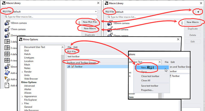

So, with all that in mind, what would be less confusing to me is to call them RUIs in all cases. So below, I show my two ideas for the macro library window but this time I call the drop down RUI File. Then either the drop down can can have a little plus sign by it to create new RUIs or there can be a New RUI button. And, in either case, the current New button gets renamed to New Macro.
But then this time I also show some changes to the toolbar panel in the Rhino Options window. The dropdown would get renamed to RUI File and the Toolbars and Toolbar Groups becomes a heading below that. And the File > New becomes File > New RUI File.
