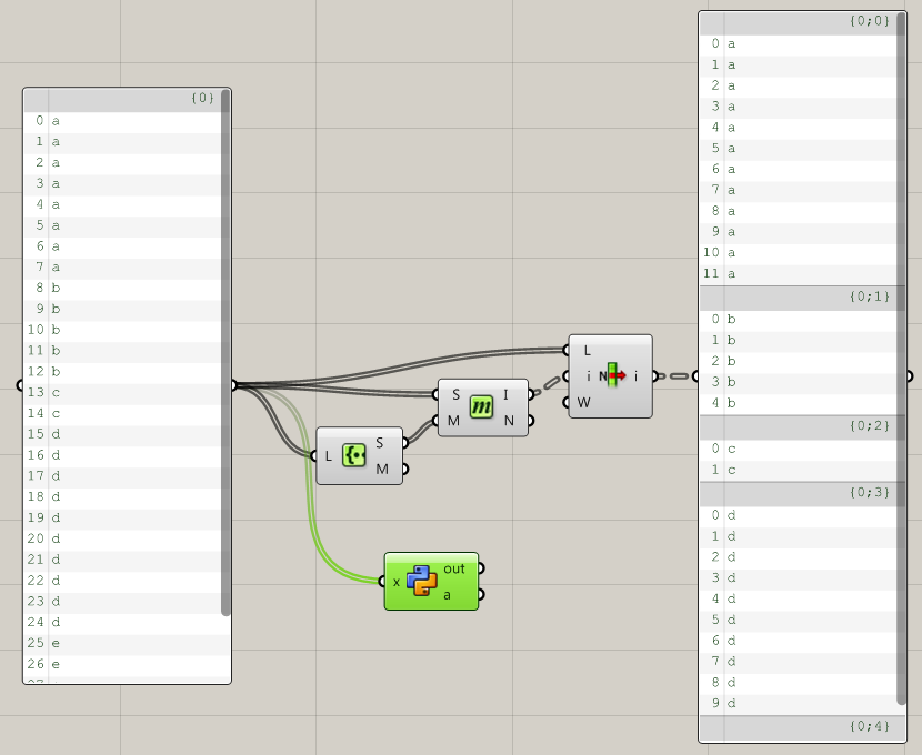

I need to be able to slice a list of points into multiple sublists, to act as a guide for slicing another list.
My list right now is y_vals = [a,a,a,a,a,a,b,b,b,b,b,b,b,b,b,b,b,c,c,c,c,c…] and I need it to slice every time the number changes. a, b and c are actual numbers, but the numbers are rather long, so I typed it out in a,b,c.
I wanted to use the slicing method of [:x], but it’s a list of 5000 over numbers, and I’m not sure how to slice a list. Thank you in advance!
split data at change.gh (10.6 KB)
Looks a little clunky to me. It could probably be scripted in a couple of lines.
Couple ways to go…here is one using Create Set, Member Index, and Partition List.
I thought about this, but what happens if the same numbers reappear down the list?
good point, my solution would duplicate values if they repeated…You could go a scripting/python route. Full Disclosure: I googled and grabbed this example from stackoverflow!

EDIT: For closure, if you are starting with a sorted list, this would also work:
Oh, they wouldn’t because I sorted them, actually, so that’s why they end up as a whole string of a, then b, then c, but I couldn’t figure how to split this list to use it as a tree data after I flattened it earlier, and I couldn’t unflatten the earlier step haha.
This worked really well to achieve what I wanted thank you!
