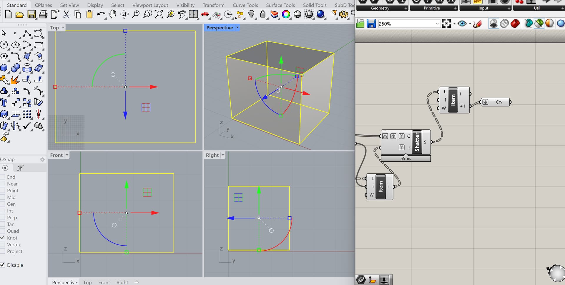

New issue today, the Grasshopper preview is now inhibiting preview of geometry in perspective mode. I have disabled the third-party plugins as you have asked.
GH Preview On
GH Preview Off
Does McNeel have a returns policy? I’ve always been very happy with Rhino products until now, but I feel as though I am doing beta testing for unreleased software.

The preview issue documented in the two screenshots has happened after I disabled any other plugins, and the Grasshopper script doesn’t contain any other plugin nodes, nor new RH8 ones. Could this issue still be related to plugins installed for Grasshopper though not utilized in the script?

Offhand (without the file) i would have to say its because nothing is selected and you have Only Preview Selected objects enabled.

@Japhy Thanks for the thought, probably I wasn’t specific enough in my post. The two screenshots show a selected box that’s modelled and visible Rhino and is not operated on with the Grasshopper script in any way. The issue is when I have the GH preview on, it hides the Rhino shaded box in perspective.
Can post the file or internalize the geometry and we can take a look. Thanks
As I think I mentioned above, unfortunately it’s project work and covered by an NDA so I am unable to share the model data. Which I understand means the script isn’t a lot of use.
That’s okay. I’ll just switch back to 7 for the immediate future and check back into 8 in a few months. Rhino/Grasshopper is easily my favorite program in the world, and I’m very thankful to your company for putting out such a tremendous piece of software. As you said, I was not made to upgrade to 8 but probably I was just excited to see what was new. I should understand that a few teething issues are too be expected, and for the integration into an existing workflow to not be completely seamless.
Thanks again.
Hi Les -
Just note that this issue is not something that we are seeing here, and, thus, is not likely to simply change on your setup during those few months. If you can reproduce the behavior with something that you can share, we can take a closer look.
