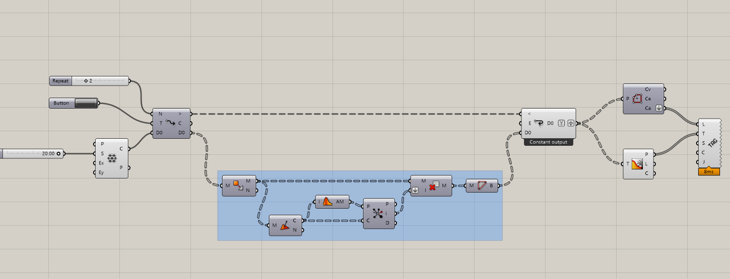

Try with this idea , you need loop to repeat the process
Sierpinski triangle.gh (11.6 KB)
Interesting way of creating the iterations “outwards”. But this is not the problem I’m trying to solve anymore. There is a photo of what I’m trying to do. I apologise, maybe I’m not explaining it right.
Use Mesh , Triangulate, Delete Faces (the one in the center) and repeat the process with loop
Oh, I think I understand. Thank you!
