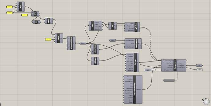

Good Evening Everyone,
I have a complex (invalid - can’t seem to fix it) mesh which I am trying to ‘shrink wrap’.
I am having trouble to get a closely wrapped output - is anyone familiar how to do so, or if I need to fix the mesh, how?
(link to mesh: https://app.box.com/s/7gyvs9u79g1klw4723yybkdorr6dpssu)
Kindest,
JJC.
235_GH_COMP_ShrinkWrap_R00.gh (16.6 KB)
The dendro plugin might be what you need, if the goal is to make a valid watertight mesh
Thanks for the suggestion - I opened Dendro but the mesh tools require me to ‘supply a valid mesh’.
