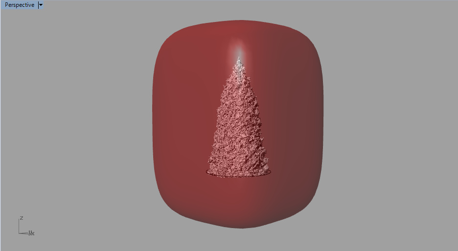

Hey Forum,
I’m really stuck with a complex invalid mesh (see below for Rhino Mesh Check details), which I need to be able to work with for 3D printing. I tried everything I know to do in Rhino to fix the mesh and edges.

It’s easy to remove duplicate faces, it is not easy to get rid of non-manifold edges. With the faces it doesn’t matter which one you remove, you always end up with an identical valid mesh. Non-manifold edges on the other hand are edges where three of more faces come together. Removing different faces will result in a different outcome.
Since there aren’t that many problems with the mesh, perhaps easier to bake it into Rhino and fix it manually?

Does your download link have the fixed mesh?
You can use the Null Item component in Grasshopper to inspect data for validity. The D output should have more information about why an object is considered invalid.
You might try _RebuildMeshNormals / _UnifyMeshNormals to see if you get rid of some of the issues with normals and then reference the mesh.
Thanks both of you, David and Vanessa - I’ve managed to get it working now!
Much appreciated.
Excellent! Enjoy!

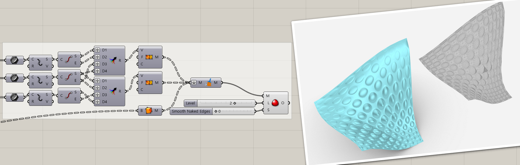

Hi everyone.
instead I have this definition with this invalid mesh in output, and I do not know how to smooth the mesh.
Can you help me, please?!
thanks a lot
Simone
Smooth mesh_ERROR INVALID MESH.gh (165.1 KB)
This could be a way.
Smooth mesh_ERROR INVALID MESH_re.gh (173.3 KB)
:sweat_smile:
Thanks a lot!!
Do you have similar solutions for hexagons definition?
Thanks
S
If you are going to use weverbird Catmull Clack Subdivision in the last step, then, even if you use hexagons, the final result will probably be similar.
