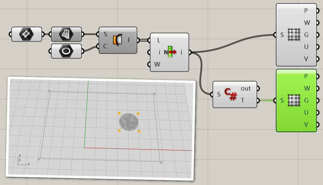

There’s no Shrink component in the native toolset, but you can do it in C#
shrink.gh (10.1 KB)

I don’t have LunchBox installed, but your surface appears to already be untrimmed. It cannot be shrunk further.
I guess that is my problem. It’s trimmed in Grasshopper but Rhino doesn’t accept that by looking at the points forming a rectangle.
I’m not sure what that would be.
Any NURBS surface will ALWAYS form a rectangle. By shrinking it, the points will get as close to the trim curve as possible, but unless the trim curve is exactly along the points grid, there will always be points sticking out of the trimmed edges.
