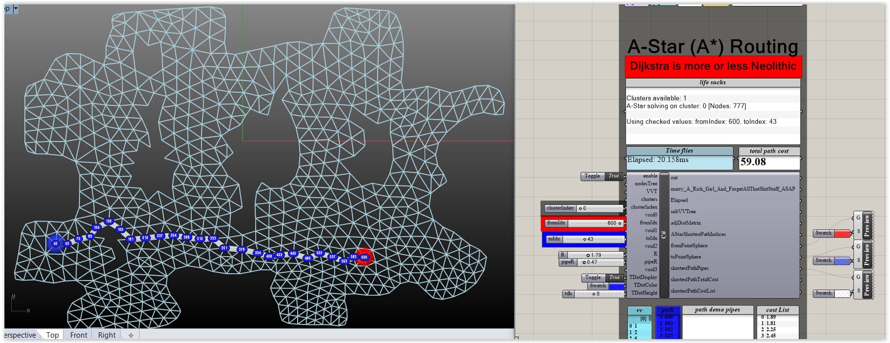

This is a classic A Star routing puzzle (Dijkstra is dead - long time ago).
I’ll describe the procedure (via code [V stands for vertex]).
  1. Given any valid Graph do the VV connectivity Tree (alter ego to an Adjacency Matrix).
  2. Using solely the VV detect possible Islands (Recursion is required for that).
  3. On per Island basis (meaning: using the related “sub” VV Tree and the V List):
3.1. Either solve it on per From/To basis (the classic way):
3.2 Or solve it on per From/ToAll basis (the unusual way):
like:
If by accident you are familiar with coding (C#) I could provide various hints/tips - but not the solution (strictly internal stuff that one).
BTW: PMST is NOT a A-Star from all to target: Compare these (i.e. a classic/standard MST does not take into account the target) :
