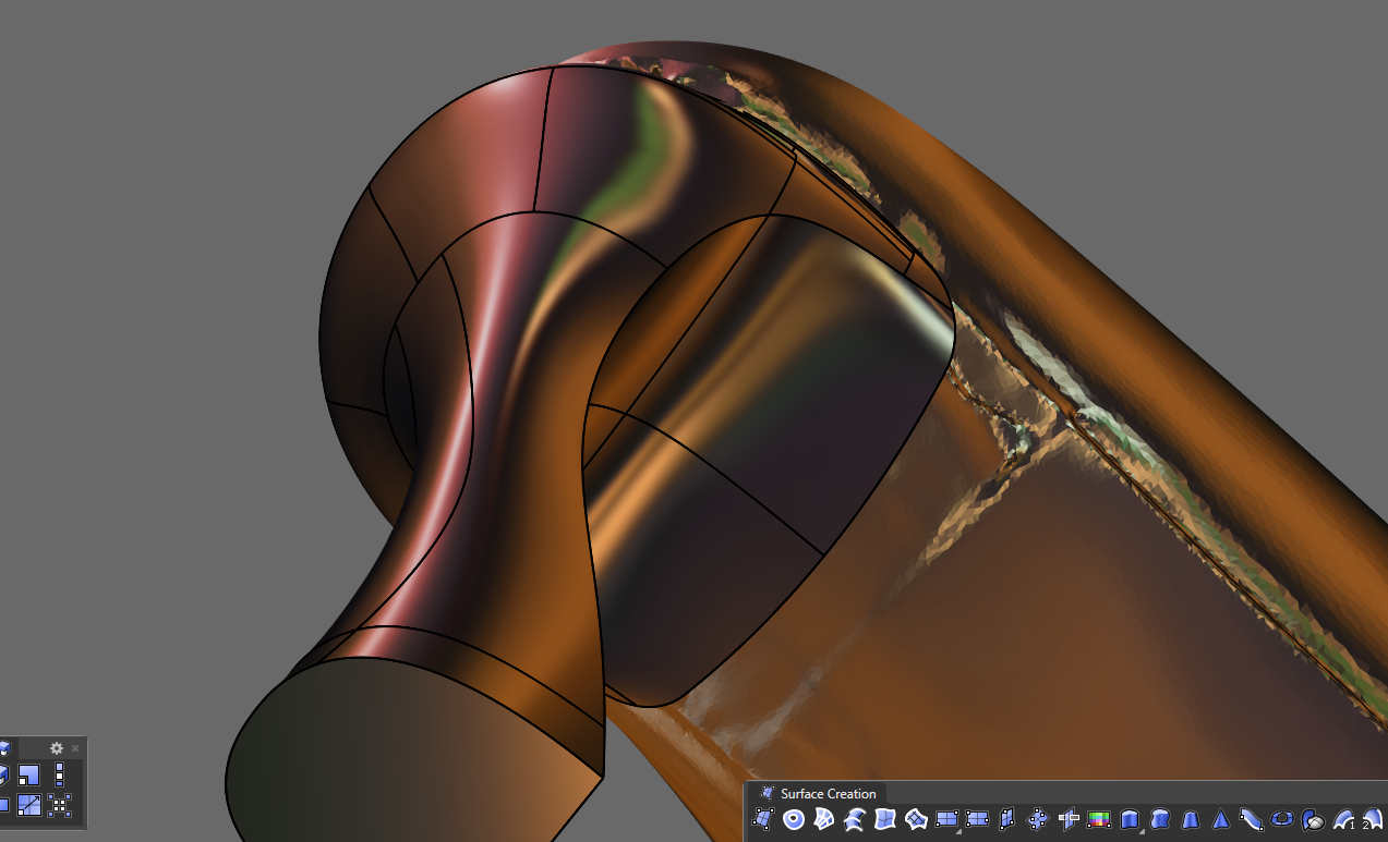

Since I already have a display mode called “Crackdown 20”, my Rhino 7 does not let me import your version. :slight_smile: Perhaps renaming it to “Tomb raider” from this panel in your Rhino before you export the ini file will fix the issue.
Crackdown 20 TombRaider.ini (16.2 KB)
try now I exported it as .ini file

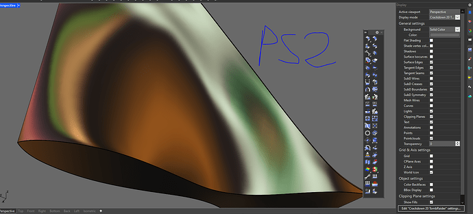

It would be more accurate to have “flat shading” enabled to achieve the PlayStation 1 effect, while without it, it looks like the remastered version of Tomb Raider.
Playstation 1
Playstation 2

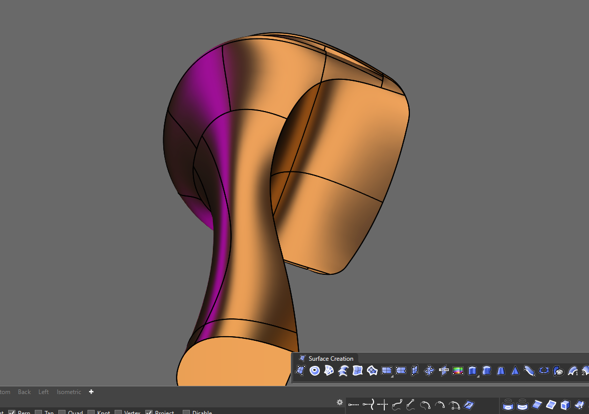

In the initial version, there’s that shade of violet I like, while in your version it’s missing. Could you make one that keeps that color? I really liked the sense of light it gave.
new png tomb raider
What violet? I’m afraid that I can’t see that colour as I’m colour-blind. :innocent:
there’s this beam of red/violet light, can you see it?
I swear I see it green… :upside_down_face:
If you have Paint NET, you can open my image and run the “Hue/Saturation” tool to change the hue level to what you see as red/violet. :smiley:
Ah damn, don’t worry about it. :sweat_smile: :+1:
