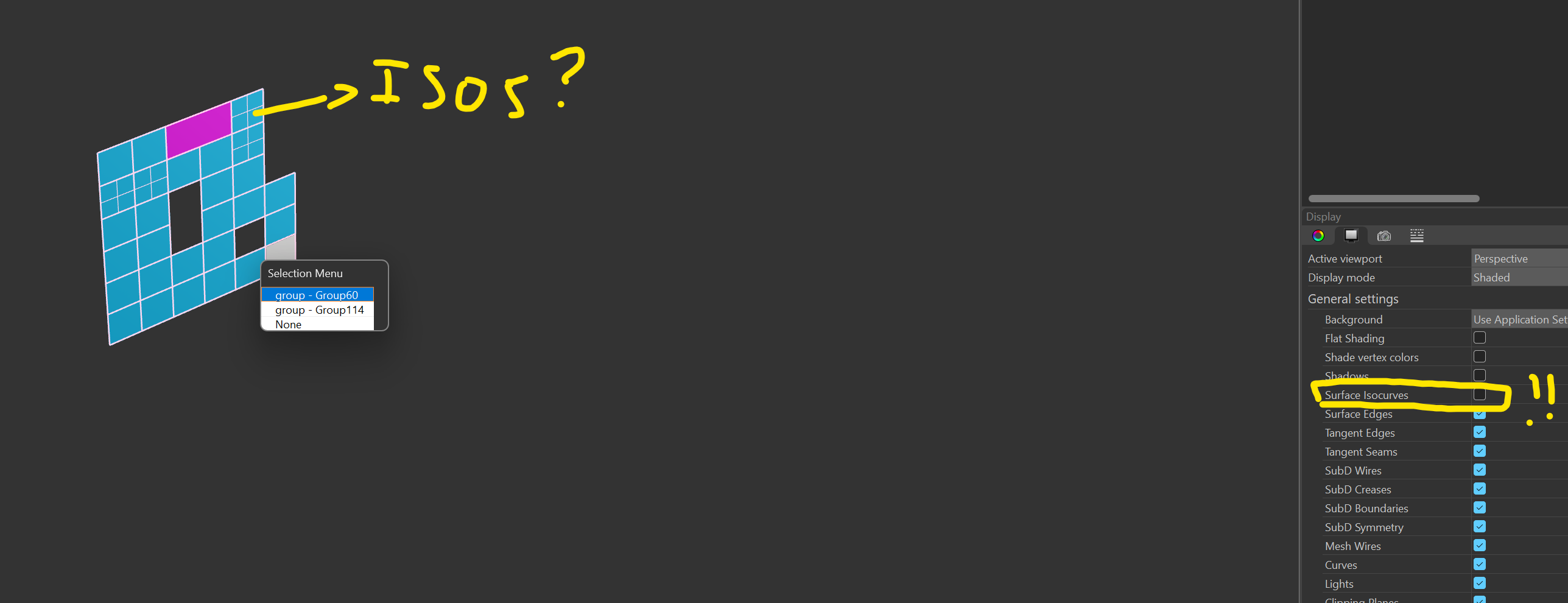

Shaded Display Showing Isocurves Despite Setting Off
I noticed the selection Menu shows isocurves on surfaces even when the setting is off. Can we not please?

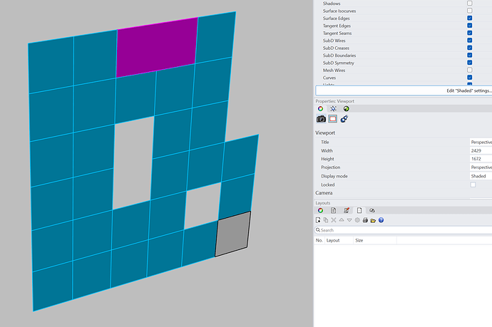

Dunno, if I uncheck “show isocurves” in my shaded display mode, they go away…
Some of them do show up when selected. Some odd display phenomenon when two surfaces are concurrent? If I move one of the surfaces away, they disappear when selected…
All surfaces have duplicates on layer revit export.
Yes they are two group of surfaces on top of each other, this way selection menu pops up.
Exactly. Also away from 0,0,0 must have something to do with it.
