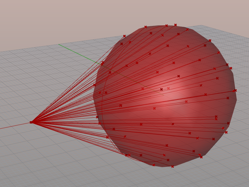

I have a geometry and a Point P
I have populated the Geometry with multiply points M
I would like to conect point P with all points M that are “vissible” to P
The best way i know to discribe this is a refrence:
In maya there is a way to select vertesies with “camera based selection” meaning you can only select vertesies seen by camera (If you have a sphere and do rectangular selection and CBS is on you only select vertesies on the side you can see)
does anybody know a way to do this in grasshopper :smiley:
i thought about connecting all M’s with P and then intersect all MP’s with the sphere and if there is a intersection i tried to cull them. but i am very new to GH and i didn’t manage :confused:

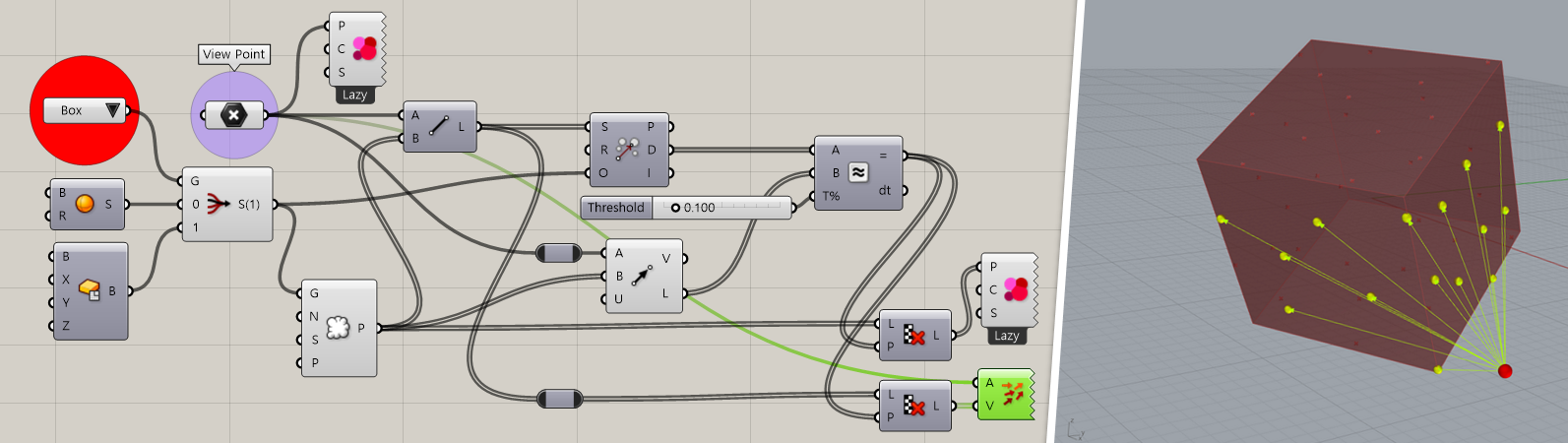

How about using IsoVist Ray and comparing two sets of vector length?
SelectingVisiblePt_re.gh (14.9 KB)
Yes. :slight_smile:
// Rolf
Hi
yes this is exactly what i need. very cool!
