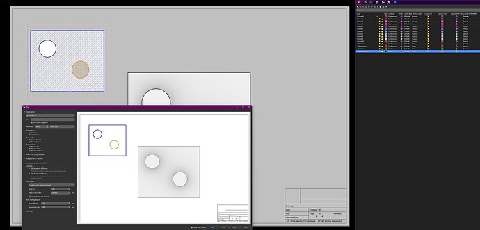

As you can see here, the hatch scale is different on viewport and page layout.
Where can I fix this? I want the page to match viewport scale.
Layout print is also not matching what I want the document to be.
Scale of hatch is very small.
Section detail window is not showing on print.
Hi Martin -
The recommended workflow is to set the section hatch scale to something that looks good on the paper size that you are using in the layout, and then set the document hatch scaling (Document Properties → Hatch → Model space hatch scale) to something that makes this also look good in model space.
There are many variables at play here - please post the 3dm file.
