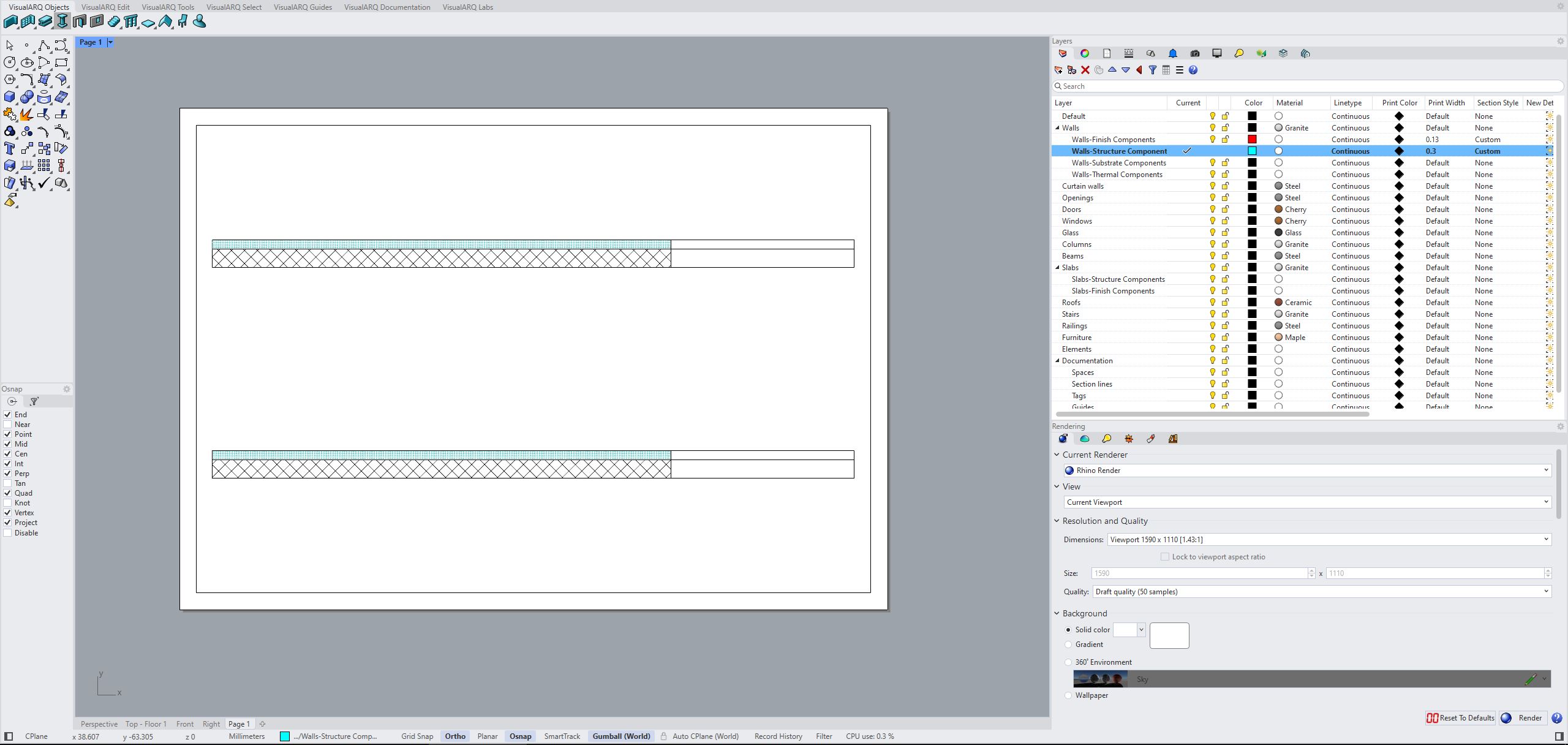

In my limited understanding seems simple, setting section style in layer and giving there a width scale gets displayed as it should in viewport, but it does not print.

Sure, this is a simple example i have both rhino and VA geometry in the same corresponding layers.
Section styles are set through rhino layers and not through VA styles. Va styles have all settings according to layer.
Layer Section Style Boundary not Printing.3dm (4.7 MB)
Display in viewport as expected, according to scale given in section style.
Display in Layout print preview off, all ok like in viewport.
Display in Layout print preview on, not ok section boundaries do not get the scale given and same happens when you print to pdf, section boundaries do not get their thickness scales according to section style.

Ahh, so yes, this is not actually a bug. Its a confusing thing we did in v8 that we don’t do anywhere else and changed in v9 because.. well.. yeah we learned it was confusing.
Width Scale is for Display only. Its the same as when you go into the display mode settings and select how thick to draw Surface Edges. It doesn’t affect Print and is only for Display. That’s why it gets crushed by PrintDisplay or Printing. For v9 Width Scale is now a Display Mode setting and Print Width is now the configurable item. We’ve also tried to show you where the print width is coming from and what it will currently be. In the image below itll be the current layer which is using 0.5 mm.
The Display Width is now a per Display Mode setting under Display Modes > Mode (“Shaded”) > Objects > Clipping Plane > Edge Thickness Scale
In v8 the riddle is harder to solve but not to bad once you know how its plumbed.
In the example below the boundary linetype is By Layer (which is the Default layer) and so the print width comes from the Default layers print width. In this case 0.5. and Width Scale is literally just for the display modes, not printing.
let me know if that helps or not.

In Rhino 8 what i am after is impossible, unless i am missing something.
As shown in the previous screenshots and per you description, whatever Print width i set in layers is applied in both cut and projected geometry when printing, which is not compatible with common drafting rules, where sections usually get thicker print width compared to their projections.

Another addition to v9 is a section boundary linetype can now be an existing linetype in the document. Eg “Dashed” where in v8 its just By Layer or Custom.
However, to v8’s point (after the other bug fix you pointed out). If instead of using By Layer for the linetype on the section style. You could use Custom and assign a custom linetype to the boundary with its own print width value. I would use MM for the Width on the custom linetype and it should be printed at that value.

In Rhino 8 Somehow i cannot get it to work. I apply custom Linetype set it as in your screenshot, everything gets the same print width.

I don’t see any clipping objects to generate sections in the file you attached?
Once I clip the Layout with a clipping plane things works as advertised over here.
This is because clippings happen through VisualArq levels and not a Rhino clipping plane.
I added a Rhino clipping plane and enabled it for Layout and top view.
Layer Section Style Boundary_Custom LInetype_RCPlane.3dm (4.7 MB)
Same result.
The left part is sectioned the right part not right?
How is this as advertised, when sectioned part is set to be 0.9mm and projected part 0.5 and they have the same width (i dont see a difference there)?
You need to move up the clipping plane, now it intesects with all the solids, while in order see what i am saying the right short solids need to be under the clipping plane, as projections. And in that case sectioned parts should print thicker than projection parts.
Ahh yes, i tossed a clipping plane out which comes in on the cplane. I moved it up so that the right hand shorter part isnt clipped. The section areas should appear to have the thicker .9 vs .3 boundary.
Does this help?
