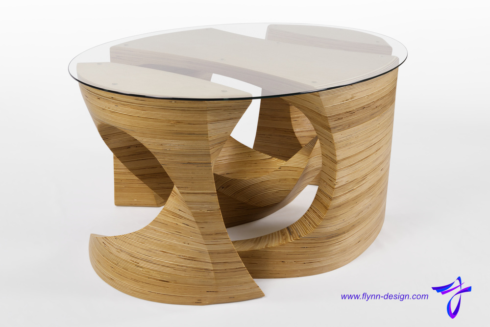

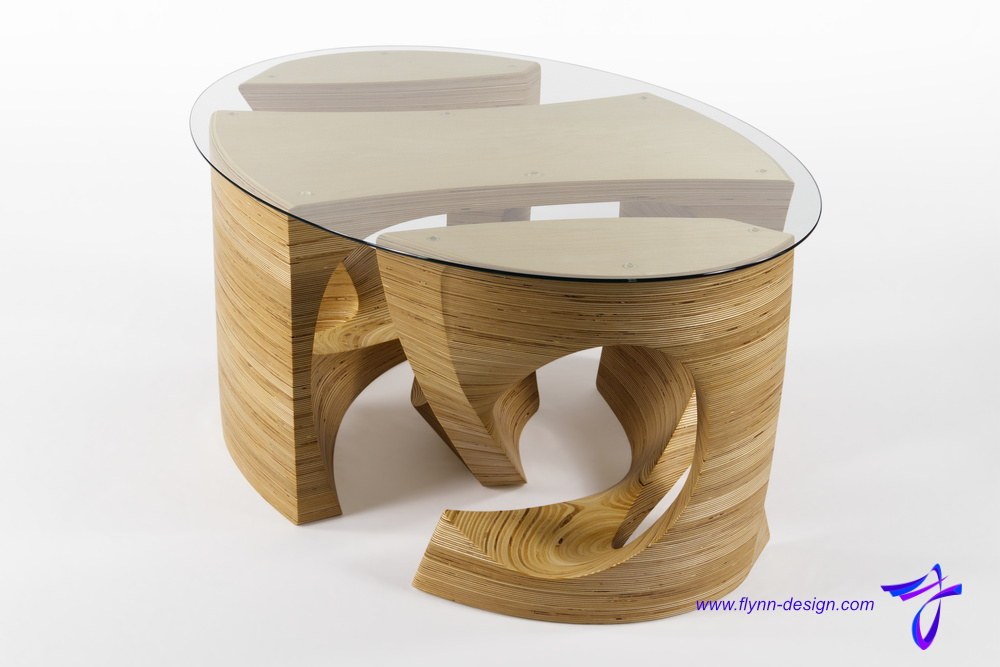

The first finished project out of my workshop, completed a few months ago. Coffee table in baltic birch plywood. Modeled in Rhino and Gravity Sketch in NURBS and subDs, prepped through Grasshopper, processed with VCarve Pro, cut on an Avid PRO 5x10 machine, assembled and sanded by hand.
For more pictures, see http://www.flynn-design.com/product-page/canyon-bridge
-Matt Flynn

Just wonderful, in both concept and execution.
